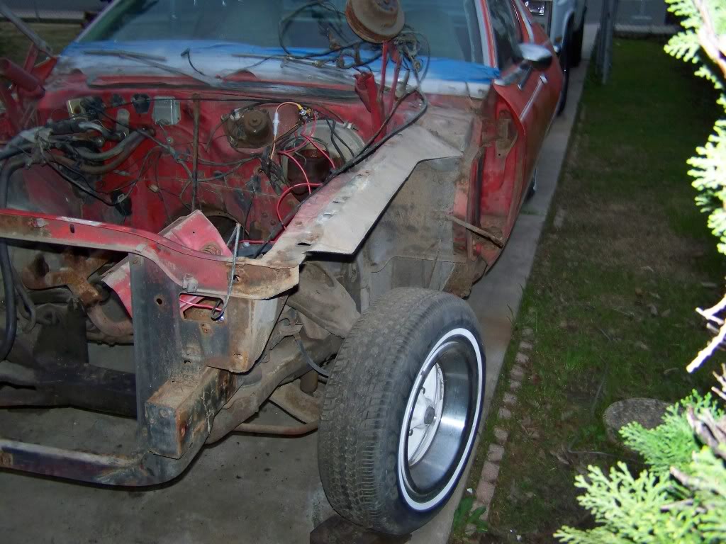

finally took the time and got them all off there was this plastic shield
Attachment 17375
Attachment 17376

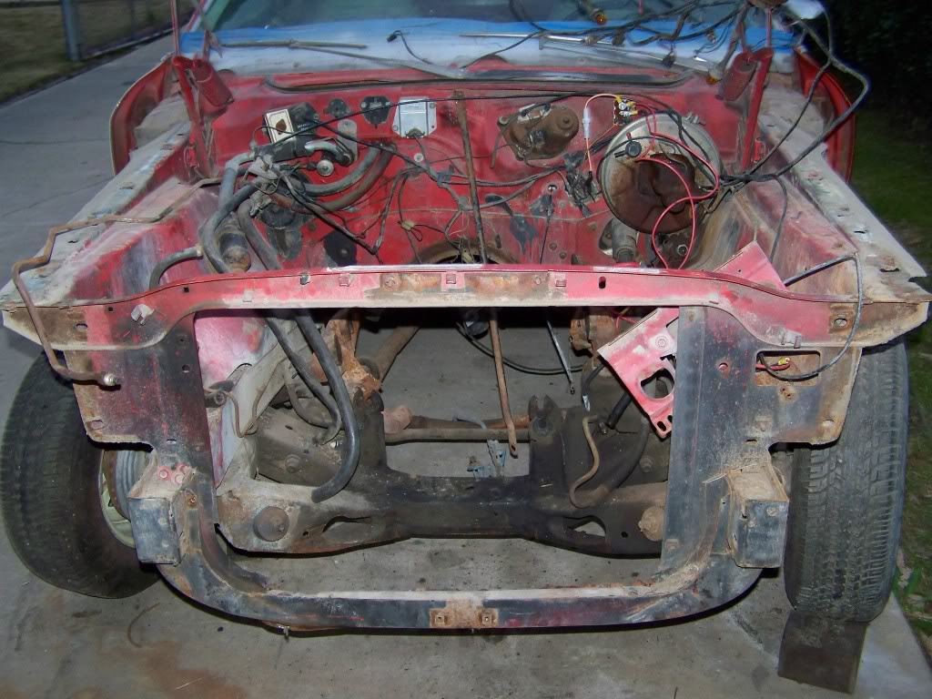

and is this supposed to be straight or evenly bent?
Attachment 17377
scotts74birds Jan 8, 2011 06:47 PM
Ummm, no. However, the drivers side of it looks correct. It almost looks like the passenger side is the result of a careless tow-job. That lower portion of sheet-metal [under the boxed area] doesnt actually support anything, but is more of a reinforcement and mini skid-plate for protection of the bottom of the radiator. So the answer is, It is supposed to be straight, but it is pulled out on the passenger side

actually i don think it was pulled out from being towed because undneeth is smashed upwards and the engines oil pan was dented the same way as well as the pully...i think the last owner jumped the car and landed on the rock

Well, ya give half the info, I guess you get half an answer! I dont give a shit what the PO did! The brace is bent foreward.
timmie124 Jan 8, 2011 10:29 PM
lol thanks for the info though whats the best way to bend that back in just hammer the living shit out of it?

I'm not a body man, so I dont know the best ways to use heat. But I would be more than happy to crawl under and give you some good measurements so you know where it should be. Do you weld? I might be scoring a shell in a local yard that has that. Or I might be able to get the guys at the yard to part with it for cheap since its not a high demand piece.
