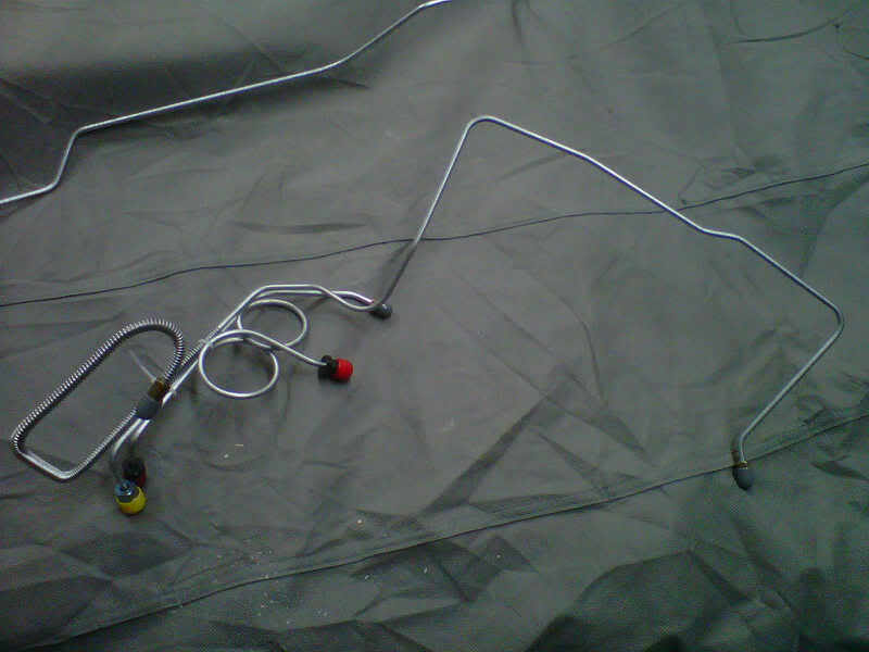

Inline tube has some front brake line sets for our cars..they will soon have a rear one available also...I am taking mine off and sending it in to them to duplicate...I will tell them to add it to there website catalog..
http://www.inlinetube.com/

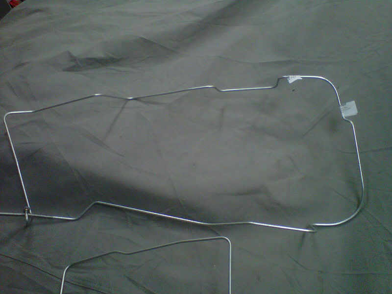

Got my brake lines from Inline Tube...the ones from the master cylinder to the proportional valve are verified....the one from the proportional valve to the driver's front wheel is verified...the other long one to the passenger side is not verified at this time..75 bucks plus shipping
Attachment 16906
Attachment 16907

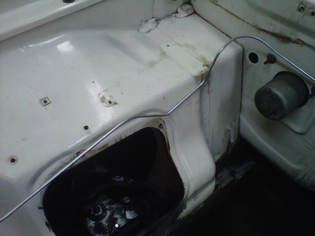

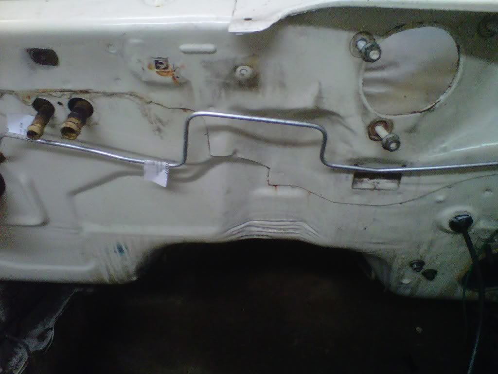

When I first found the brake lines at In-Line Tube they are listed for a 1976-1980 Plymouth Roadrunner/Volare...I assumed a F body was a F body and I even called them...hence the learning curve...Plymouth routed thier front brake lines different than Dodge did...the ones from the master cylinder to the proportional valve are good to go...I have to send three of mine back to make them for a Dodge...the front driver's side was close but not right..see where the rust line is that's where the brake line should be...
Attachment 16875

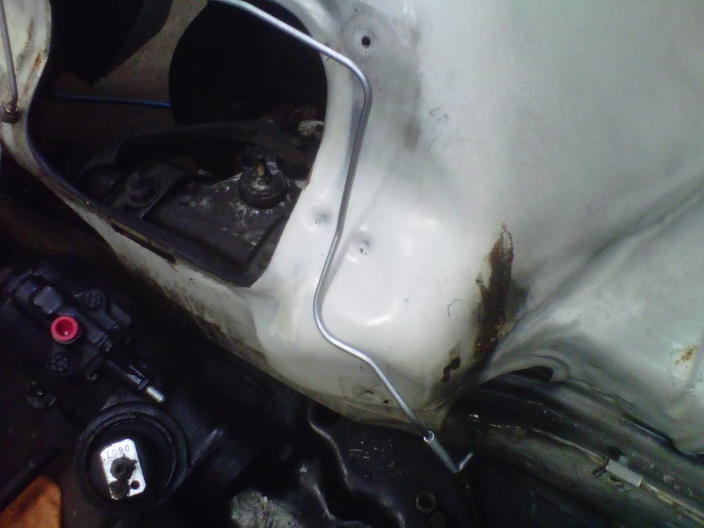

The one for the front passenger side was meant to run against the firewall...mine runs along the bottom of the radiator support...
Attachment 16876
Attachment 16877

Yep I saw it somewhere else..to each his own battles...Mine was my bad...I am man enough to take the blame...that's why mine are going in for everyone else...it's a pain for me but a joy ride for others..3 brake lines to them for them to make it for my car...believe me I will let you know
bremereric Mar 5, 2011 09:11 AM
Okay I will take half the blame for not knowing better...Inline tube doesn't either...they list the lines for a 76-80 F body...I was told by someone that did his car ten years ago that 76-77 were routed to the front radiator support and 78-80 were routed against the firewall..I learned something new....I let Inline tube know too
