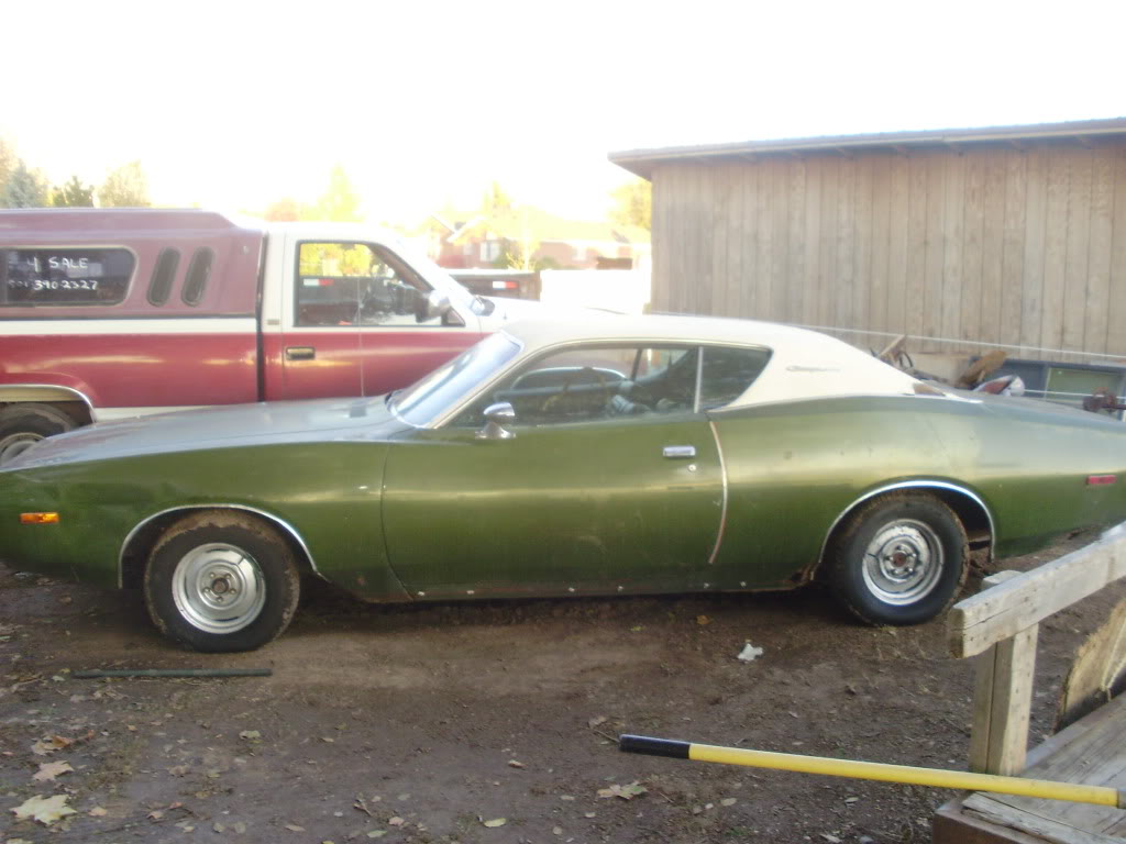

1 Attachment(s)
Attachment 16855

LoneWolf Mar 5, 2011 04:22 PM
finally! thanks rdrunner!
