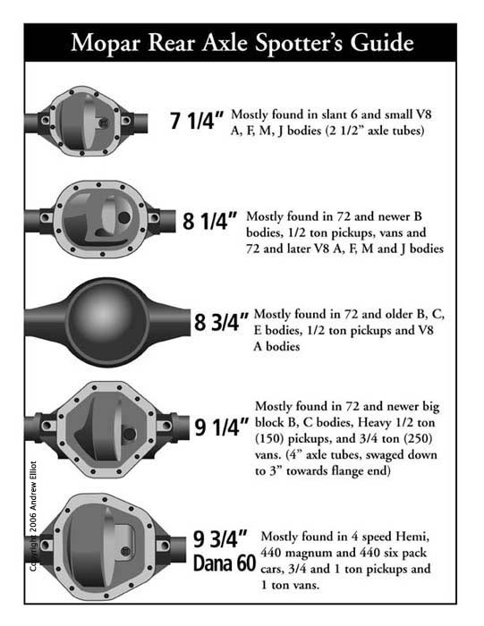

Post a picture of the rear end.
78D200 Nov 5, 2012 02:47 AM
1 Attachment(s)
If your service manual is a factory issued book, I'd believe that before some articles found on the web. Here is a pic of what most of the axle's diffs look like. You should be able to figure out what you have based on this.
Attachment 14140
mychrysler Nov 5, 2012 05:27 AM
Thank you guys, yes I definitely have the 8 3/4 according to my serv. manual and confirmed with the picture posted by 78D200. Thanks guys.
