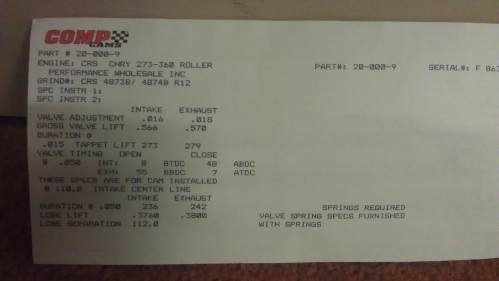

I brought this cam for my supercharged 360 magnum engine. I was going to run solid lifters with it but now i would like to save a few dollars and run my existing hydraulic lifters. Can i use hydraulic lifters on a solid cam. The only difference i can see between a hydraulic cam and a solid cam is the lobe width or is it more complicated than that?

just saw the valve adjustment on the cam card
cheers
Coronet 500 Mar 11, 2014 03:31 PM
That valve adjustment shown for solid lifters is the gap between valve stem and rocker tip.
For hydraulic the pushrod should go into the lifter and depress the plunger with no slack or gap in the valve train.

On my Hydraulic cams I usually run .060 but I have never run a solid before so I would just set as per the card.
