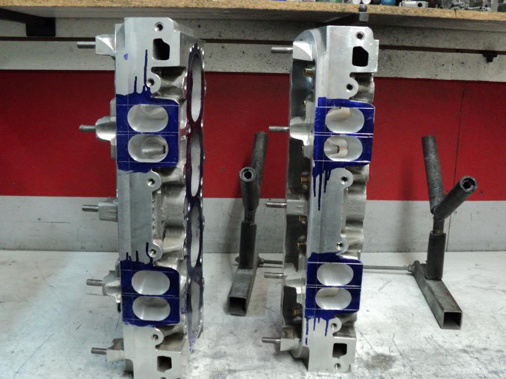

Moparbob Apr 13, 2013 08:43 AM
5 Attachment(s)
That gets expensive to put it bluntly ?
600 hp small block is doable, a little tougher on 92 Octane pump gas but still doable.
The only tricks involved really are shooting for a good useable Torque curve, and not having to rev it to the moon for the hp. we shoot for good Torque by 3500 and peak hp in the 6,000 rpm range.
Here is what we do here at my Shop, just our opinions, as we are doing one right now for a Customer, 92 Octane pump gas.
just the basics;
* R3 340 Block, 9.6 Deck height, 59* lifter(Stock Blocks do not like 600hp for an extended timeframe)
* Solid Flat Tappet Cam. (Roller Lifters are a P.I.T.A. and EXPENSIVE in the R3's)
* INDY 360-1, 0or 360-2 Cylinder Heads(Forget the Eddy's orothers for REAL 300 cfm capabilities on REAL Flowbenchs @ 28" 2O under .600" ift)
* Good Idea to do the Block Oiling Mods, Drainbacks & Main Feeds to 9/32"
* 4" Stroke Crank, H-Beam Rods, Forged Pistons, (408 Cubic Inch can make the power at a lower rpm)
Not trying to discourage you, but here is a few photos so you get the idea the amount of work involved. This is still preliminary Chamber roughing and porting prior to Flowing and adjustments.Attachment 13671
Attachment 13672Attachment 13673Attachment 13674
