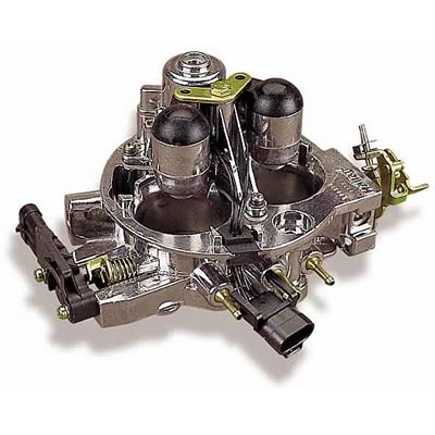

78D200 Mar 14, 2011 02:33 AM
Is this a TBI (LA) or MPFI (magnum) motor?
The normal tune up parts are always a good start. There are multiple MSD ignition boxes out there that you can use, you just need to read up on each on and figure out what is best for you. Headers and a true dual exhuast will help the motor to breath better.
CantRamItDodgeIt91 Mar 15, 2011 09:57 PM

78D200 Mar 16, 2011 03:01 AM
1 Attachment(s)
Under the hood. :p
Just remove the air cleaner and see if the "carb" looks like it has two plastic injectors (one over each barrel). If it does, then is TBI (Throttle Body Injection). If not, it'll either look like a normal carb or a normal throttle body and have an injector per cylinder.
TBI:
Attachment 16756
