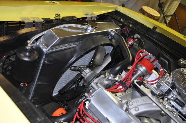

maddawg57 Jan 15, 2011 02:28 PM
3 Attachment(s)
I was running a Afco 22" core aluminum radiator with a 2400 cfm flex-a-lite pusher fan ,and a 17" flex-a-lite 5 blade fan. With all that my car still ran to hot,and the 65 amp alternator was worked to its limits even with a relay.
I replaced the radiator with a Champion 26" core radiator that bolted like the factory one ,and accepted a factory fan shroud. Problem solved, I no longer need the pusher. I got the radiator from Reliable Radiator on ebay for $289 delivered. They have a 60 day cash back,lifetime warranty,
they make radiators for all applications ,2 to 4 core. Check them out I'm glad I did. Bob
Attachment 17316Attachment 17317Attachment 17318
auerdoan Jan 16, 2011 05:04 PM
That Champion really looks nice!
