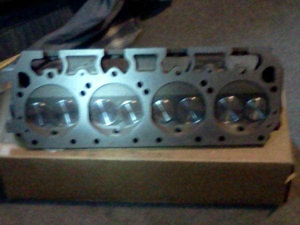

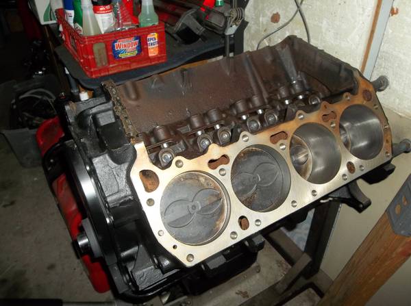

Can I put 906 heads on a 4006630-440-3 block. There seems to be a difference in the cooling ports between early and late model heads...

captaindanger Mar 20, 2014 08:58 PM
1 Attachment(s)
Attachment 8688
captaindanger Mar 20, 2014 09:02 PM
1 Attachment(s)
Attachment 8689
captaindanger Mar 20, 2014 09:08 PM
http://www.440source.com/blockinfo.htm
RacerHog Mar 20, 2014 09:26 PM
Looks good to me.... As long as the hole in the head, gasket and Block line up... You should not run into a problem.
Might have a little more heat in the middle exhaust side of the head from the lack of the lower 2 water passage ports... Nothing to worry about at this point....
You just have the early block....
