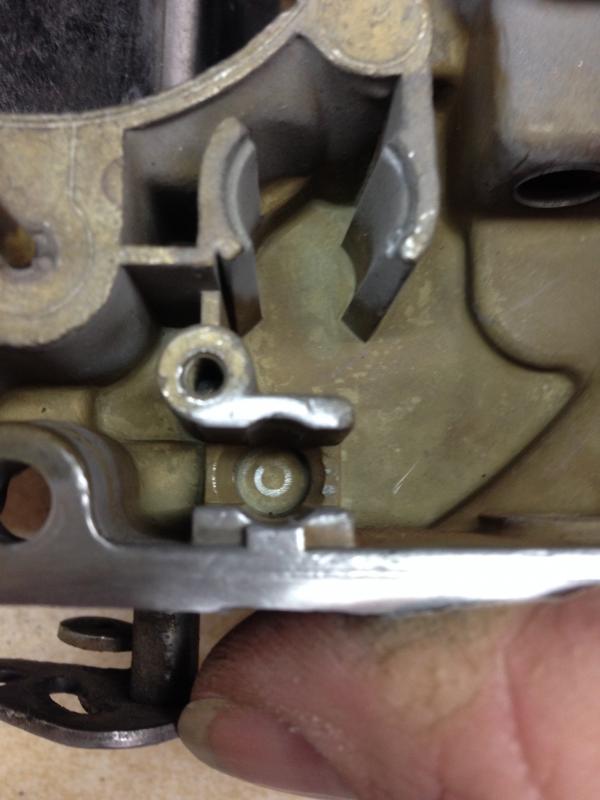

I've got the carburetor complete disassembled and rebuilding right now, I did put my finger on #1, un turn the engine until compression pops my finger, i set the rotor, it trys to start, it almost runs as long as I hold the starter, but won't run on its on. I figured its a fuel issue, the car sat for years and after tearing the carb apart, there wasn't a rubber part that wasn't ripped, cracked or rotted. Im just about to try and put it back together. My first rebuild.

jabo51581 Jan 19, 2014 11:40 AM
2 Attachment(s)
well, I'm rebuilding the carb(my first rebuild) that happened to be stripped out and the bolt secured with liquid nails!? Re threaded, problem solved. Now Im at a point in rebuilding where I'm installing a RETAINER PLATE and the top half of the carb, I don't remember removing anything from beneath the plate, but it appears something was there at one time, maybe this carb is a MUTT. Any input on what might go under this plate? Single barrel Holley-S6-225....
