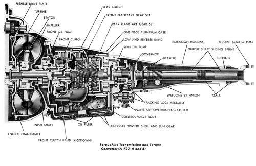

My next door neighbor recently acquired a 1966 Sport Fury 111 that is in very good condition. original 383 engine and transmission. He plans on restoring it and very adept at doing the work. Unfortunatly the transmission has lost reverse. Before he removes the transmission; (he has no computer to go online so thats why I am posting this for him) we are assuming the transmission is a 727 (it is a 3 speed auto.) Does anyone know where I can get him an exploded drawing of this transmission; and who has the best rebuild information book.

ZombiePopper Dec 27, 2013 07:38 AM
1 Attachment(s)
Attachment 12376
