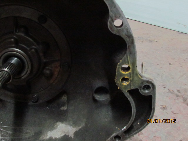

the area above the starter. your pic's show aprox 1 inch space between the dowel alignment hole and the 7/16 bolthole.. big block and small. however. this tranny. "came from a 64 cuda. had a shorter tailshaft.. so i gutted my 6 cyl tranny and just used the case from the cuda's 904... now these were only made from 63 to 65. the 66 had a slip yoke for the tail 63-65 still had the trunnion joint.. push button!!!. not tryin to use a newer one???
anyway's. mine. and iv'e seen the same measurement on late model 904's... . the measurement between those holes is aprox 1/2 inch. so i'd have to trim the block to make the starter fit. and drill/tap a new 7/16th bolthole in the block.....SCREWING me if i find the right one too??

Canfield Mar 2, 2013 02:52 AM
pic's will help huh?
2 Attachment(s)
Attachment 7022
Attachment 7023

another thing i see different. the attack of the 7/16 bolt.. comes from the engineside and threads into the bellhousing. just like the 6 cyl engines do. and this tranny... all the bolts attach from the tranny side into the block.
440roadrunner Mar 2, 2013 09:44 AM
No, you have the engine transmission mis-aligned or twisted. In the photo of the transmission you posted the bolts are from top to bottom:
1---3/8" bolt from rear of bell into block
2--Dowel alignment hole
3--7/16 bolt from front of block into bell
4--Top starter stud and nut
5--Bottom starter bolt.
You have something out of line. That bell fits a small block.

Canfield Mar 2, 2013 01:29 PM
your confused..
if you notice the yellow crayon marks on the block? the distance between the dowel hole and the bolt hole? on the tranny it's 1/2 in.. on the engine it's just over an inch.. iv'e had this all together. it all ligned up. converter as well. minus the starter...and that 7/16 bolt...

Canfield Mar 3, 2013 02:48 AM
see reply #7... above. pic #1 is the standard 904 everybody's familure with. (although it's a pushbutton case)
pic #2 is the starter side of the block. see where the standard 904 would bolt marked by the yellow crayon? notice it now?

Gorts 5th Mar 3, 2013 05:54 AM
You have to have the trany twisted, the two bottom holes are for the two bolts from the block side..." 5/8 socket"
the other four "9/16" socket after the pins
so fro the bottom up it should read blot pin bolt bolt
i have in stalled dozens of tranies over the years and you can easily get it misaligned especially when your lying on your back.
i always target the pins first when installing.... the holes second from the bottom of the bell housing.
also i notice in your pic that your pins are not tapered which makes it harder to align and get them into there respective pin holes.
also when you are installing the trani you have the torque converter installed on the bell housing not the motor also make sure you have the torque converter totally seated inside the bell housing/pump if you don't get the converter seated all the way that will also interfere with your alignment..
