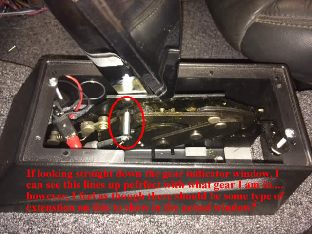

I have the Hurst Pro-Matic 2 truck shifter in my car. I bought the car with this shifter already in the vehicle, so I don't have any original parts that may have come with it new if I am missing anything.
1- I need to get the gear indicator window for a reverse valve body. This I can find easily online.

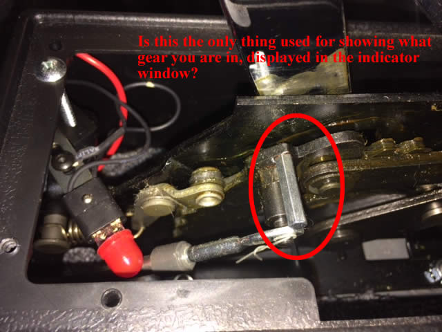

2- The indicator window I would assume shows you what gear you are currently in, and it does not. What part am I possibly missing for this to work?
I've attached a couple photos from inside my shifter. I can see where something could attach to that would easily indicate what gear I'm in, but there is nothing up by the actual window to show through.
Thanks everyone!
~Phil
Attachment 8923
Attachment 8924
RacerHog Jun 5, 2014 07:27 AM
Not sure..... This might help
http://www.hurst-shifters.com/pdf/1591043.pdf
hckrphil Jun 5, 2014 08:53 AM
Thanks Bob!.... everything looks the same as to what I have in there...... hmmm
I've emailed my pictures to Hurst....... let's see if they respond.....
Phil
98 SNAKE EATER Jun 6, 2014 07:51 PM
It's the same thing on mine
I emailed Hurst about it and they said that's just the way it is (weird)
