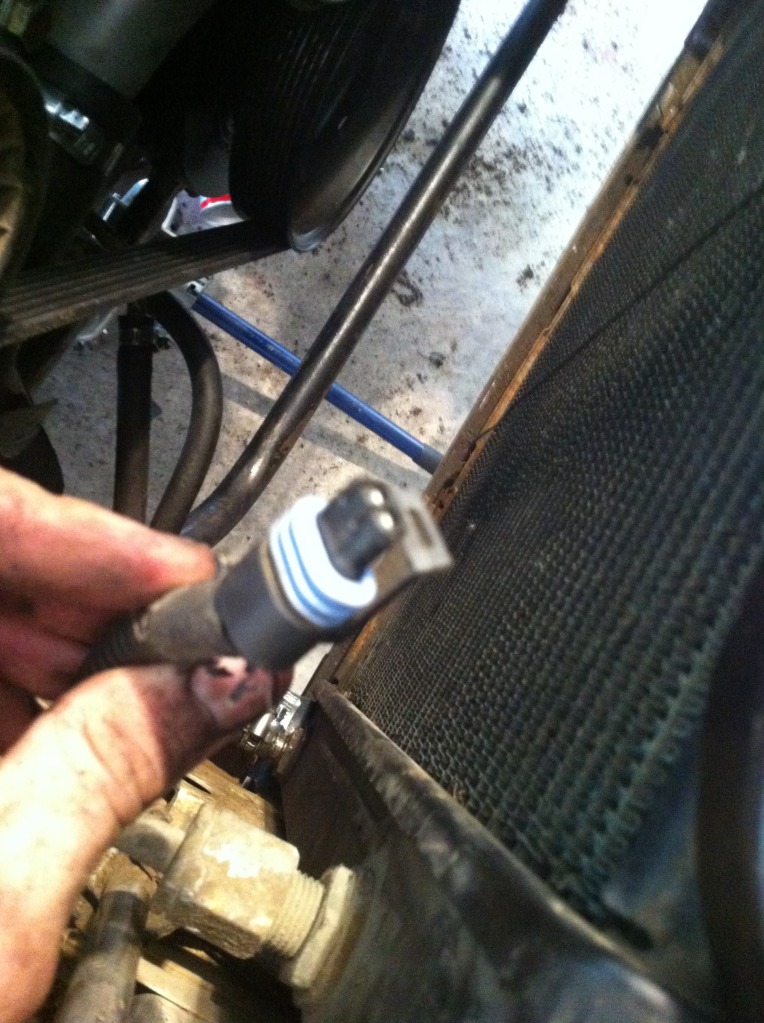

In need of some help I have a 1998 jeep 5.9 and I just rebuilt the motor but in the move some cables lost third labels and I can't for the heck of me figure out where they go here they are
Attachment 14426
It comes out down by where the ele fan plug comes out

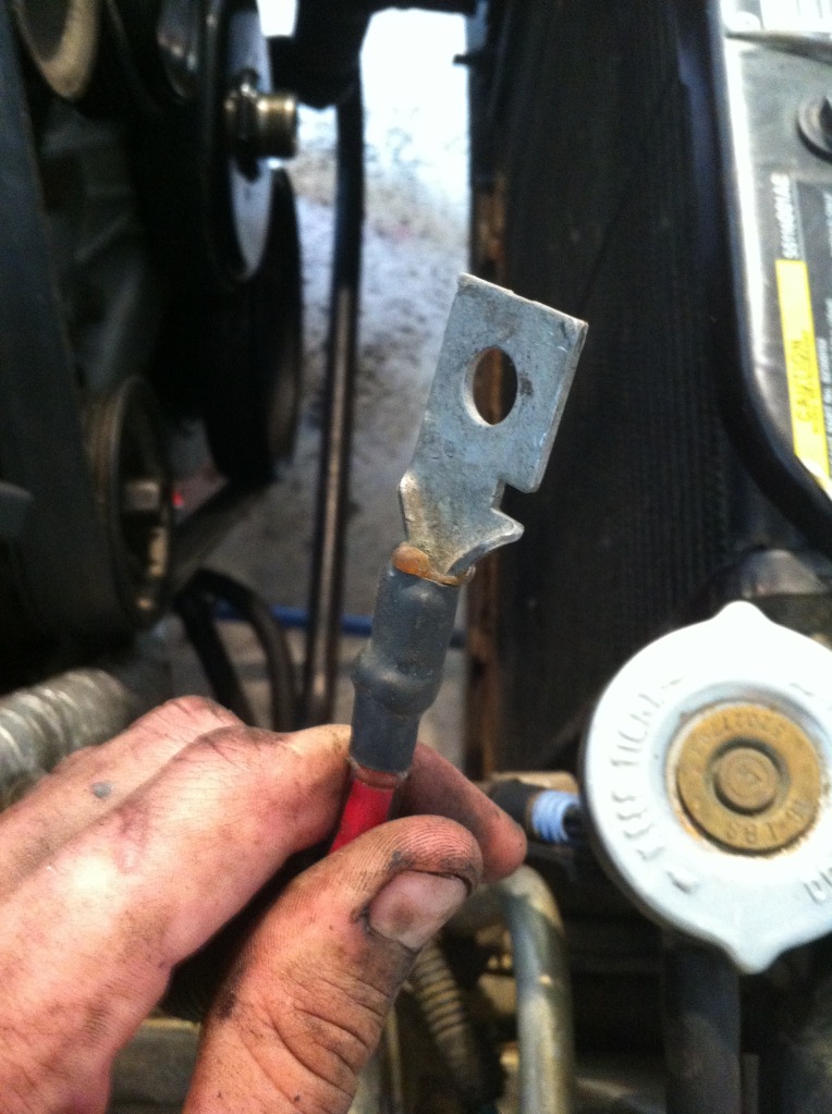

Attachment 14427
Comes out of the hardness on the passenger side by the injector plugs I thought it was for the ax pipe but does not fit

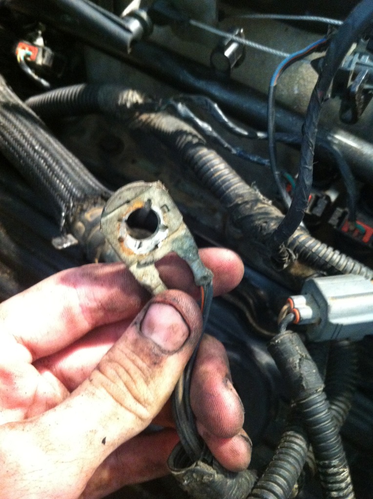

Attachment 14428
Looks like a fuse box wire but there's already on there? Are they both Spose to be there?

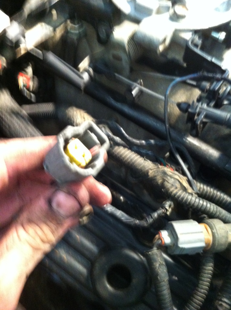

Attachment 14429
I have no idea about this one... Please help please

First one should be Idle Air Control behind TB on the rear most upper sensor. Only other sensor that uses that type terminal is AC junction but its on the other side. And secondary AC E fan power.

1. IAC control on the rear of the TB or the aux E fan which I don't see attached in your picture.
2. IAT sensor in the manifold "Intake Air Temp" Only other thing it could be is washer tank volume plug. But the colors changed to black in other models.
3. Power
4. What are the the color of the wires? With the keyed lip it, look to see if you have a ground strap on rear of passenger side cylinder head. Or behind the coil bracket under the alternator.
