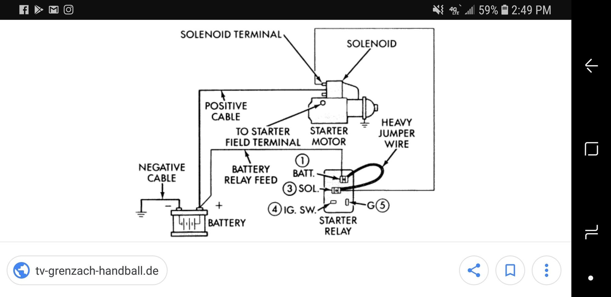

https://cimg0.ibsrv.net/gimg/moparfo...e8e38ea645.jpg
I have a 72 Dodge Charger with a 440. It runs just fine normally. The other day when I go to turn the ignition nothing happens besides the fact that the face of the air conditioning pulley clicks. I verified that my battery has juice with a mutimeter. I put a new starter relay in it and it works like a charm. Next day same thing, turn the ignition wont crank. I jump the wires by putting the starter solenoid wire to the possitive part of the starter relay, it works and i drive it home. Next day it cranks again and drive it about 4 miles but I stop at a red light for between 1 and 2 minutes and the engine shuts off. Immediately I put the car in park and turn the ignition and nothing. Please someone with more knowledge on this give me an answer, some help, or suggestions.
- I confirmed the battery is fine and serviceable
- It has a new carburetor
- It has a new fuel tank and fuel filters
- It has a new mechanical fuel pump
- It has fuel
I personally believe the issue is electrical due to the fact that I turn the ignition and nothing will happen but when I jump the wires on the starter relay the starter will engage

Possible bad ground or neutral safety switch.
RacerHog Sep 26, 2018 07:47 PM
I'm with you on that one.... Check it with a test light when it happens.... :)
