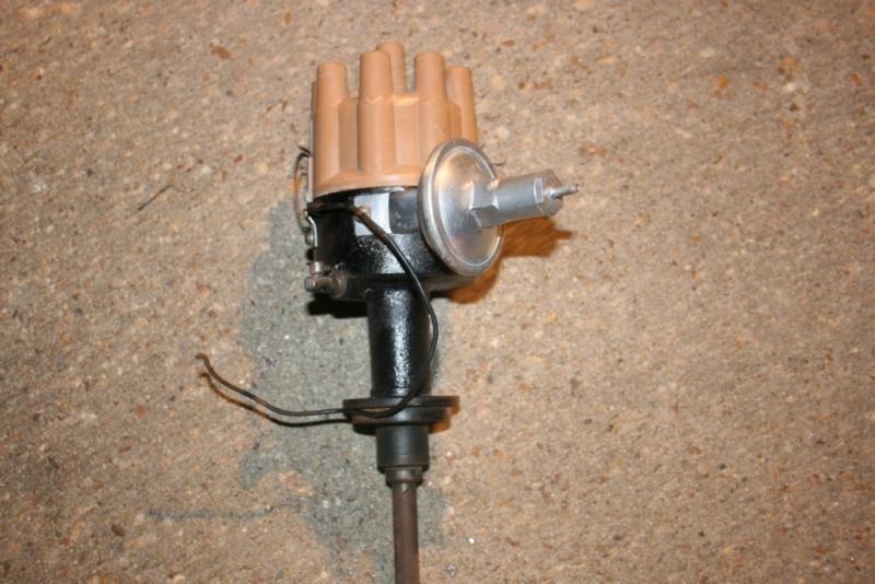

Been searching around can't find the dual point distributor...any idea's. does it have a tach drive ....mechanical or vacuum advange ?

They have a vacuum advance, no tach drive, cast iron body. Same distributor was used on the street hemi. I will post a picture of mine. They are a little hard to locate. I think they were made by Prestolite.

Here are a couple of pictures.
Attached Thumbnails 1967 GTX Owners-img_2286.jpg   1967 GTX Owners-img_2287.jpg
