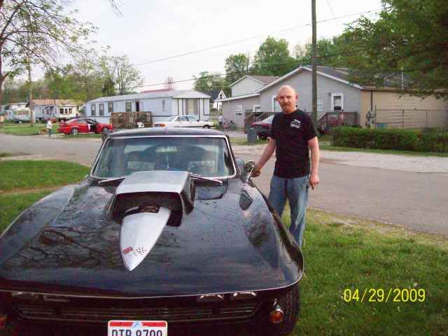

I was building a '64 vette with a blower and wanted something to cover what was sticking thru the hood. On that particular car, I had a '67 big block hood and wanted to keep something looking sorta stock. I split down the sides, raised the top about 4 inches, then fiberglassed it back on to make a scoop. You might think of something along those lines.
You might even have the option of a fiberglass 6 pack hood to cover it, and save a lot of work.
