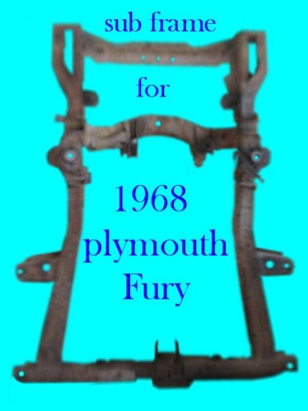

C- bodies do not have "K" members they have a sub frame and yes the motor mounts are different. I don't know if custom brakets are available for these. Try schumaker. Other wise you will need to swap the sub frame. A lot of work the front clip will need to be removed. I hope you can find some custom brakets.

Hits the box? That doesnt sound right, usually some thing would contact the steering comlumn. Headers are a big pain in a c-body not a popular body style yet so not much out there. You might find it easier to get the right manifolds.
Was there any problem with the motor mounts? I thought they were different for small to big block. Might be the motor isn't setting just right does it look straight? I won't be surprised to find out I was wrong, it just seems this was a known fact, might be the same as the rumor that 76 and later 400 blocks were thin wall and could not be bored much. That one seems to have been false, but was once concidered common knowledge. Good luck with your swap.
