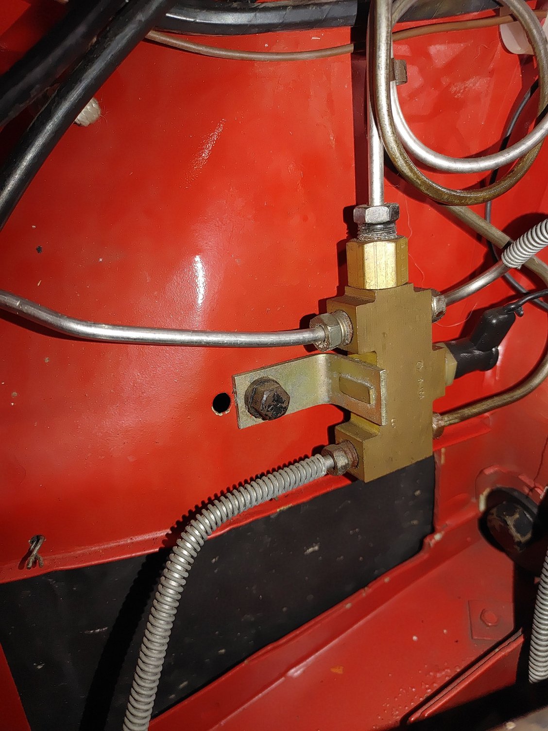

Also...here is a picture of my current proportioning valve. Can someone help me identify it?
