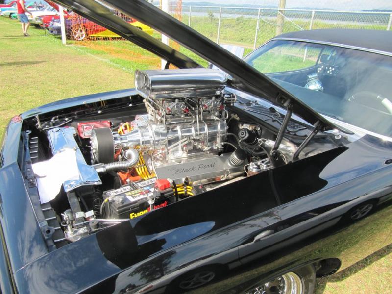

why only a 6 pack
6 packs are cool to look at but 2x4s are the way to go (lol) the issue is people who think they know fiddle with them once its up and running keep hands off never had a issue running 2x4 760 cfm

On the subject of sounds nothing comes close to a 440 and a big blower winding it self out under full boost
