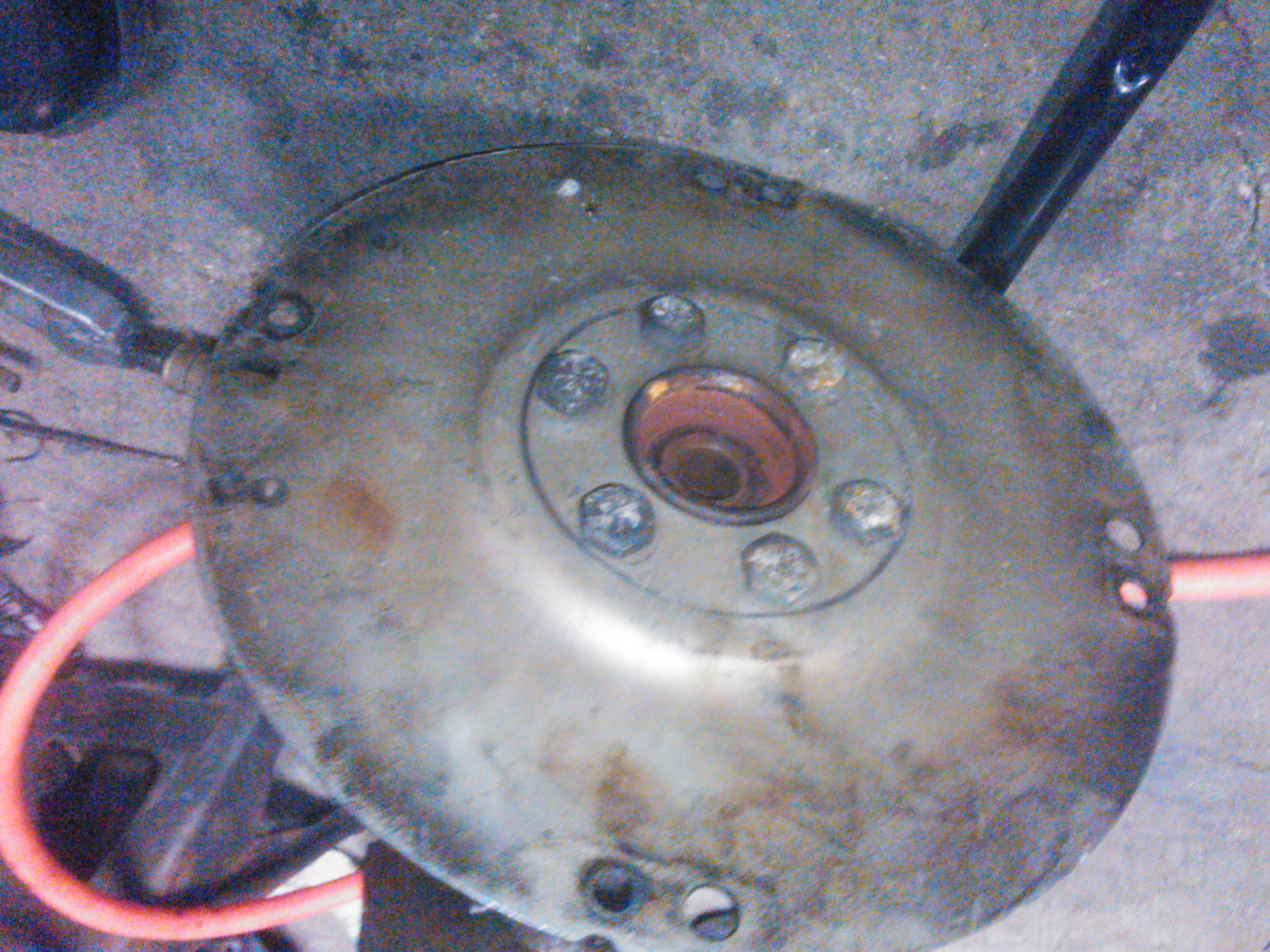

Do you have the motor out and can you post a picture of your converter?

4 Attachment(s)
Attachment 9875
Attachment 9876 Attachment 9877 Attachment 9878 Here are the pics I got. The weight on the flexplate is on the crank side. There is no weight on the convertor. Thanks for all your help |
For a hundred bucks at summit you can get the flexplate you need for a 360.
Is the B&M 10236 the one you mentioned?
Here is its description Flexplate, External Engine Balance, 2-Piece Rear Main Seal, SFI 29.1, 6-Bolt, Chrysler, 360, 727, Each |
I have used the 360 B&M flex plate Good product !!! Looks like someone took a big bite out of it...
