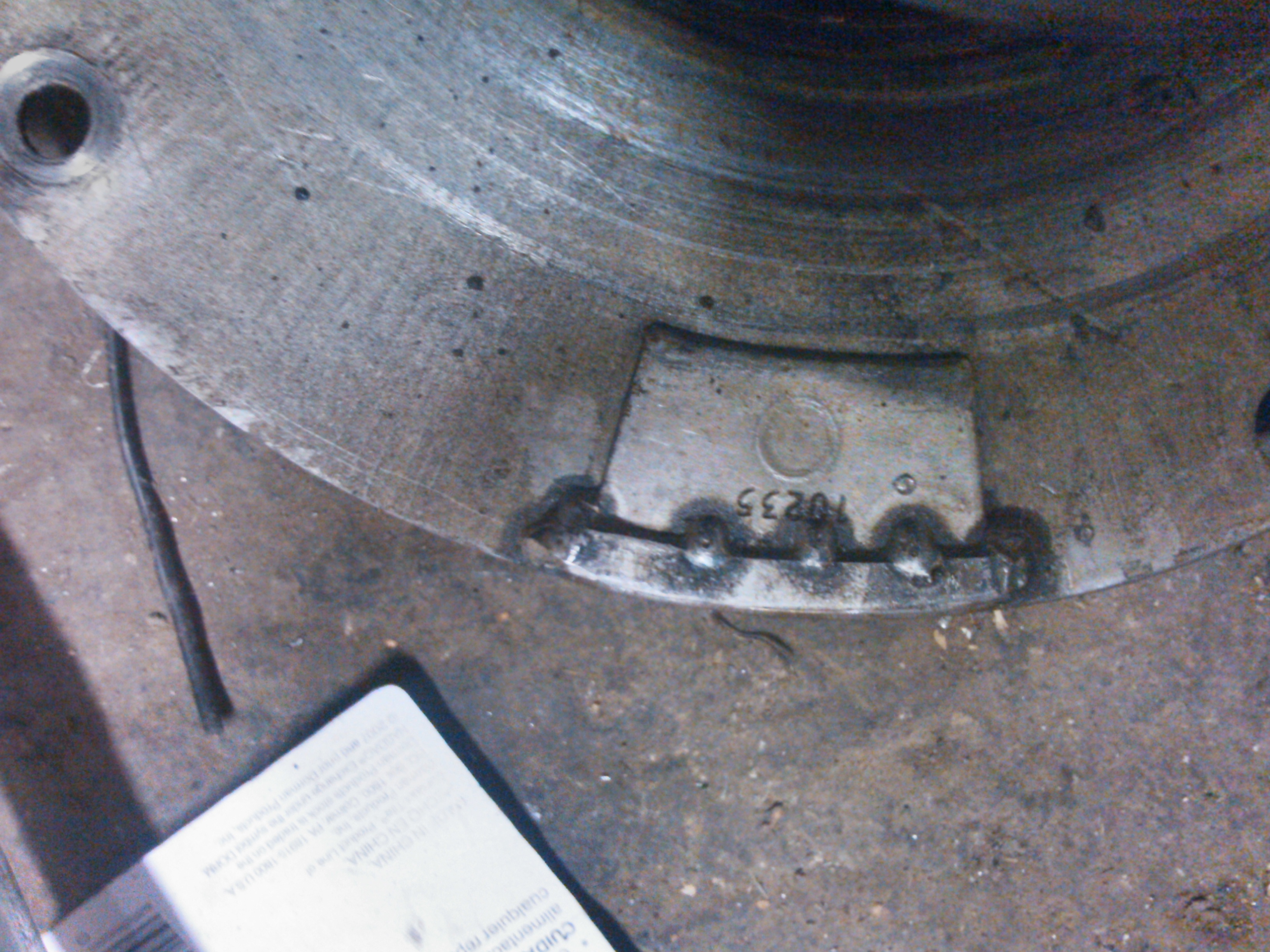

Jener's Avatar
Joined: Sep 2015
Here are the pics I got. The weight on the flexplate is on the crank side. There is no weight on the convertor.
Thanks for all your help
Old Sep 23, 2015 | 07:22 PM
For a hundred bucks at summit you can get the flexplate you need for a 360.
Old Sep 23, 2015 | 08:13 PM
Jener's Avatar
Joined: Sep 2015
Is the B&M 10236 the one you mentioned?
Here is its description
Flexplate, External Engine Balance, 2-Piece Rear Main Seal, SFI 29.1, 6-Bolt, Chrysler, 360, 727, Each
Old Sep 24, 2015 | 07:13 PM
I have used the 360 B&M flex plate Good product !!! Looks like someone took a big bite out of it...
