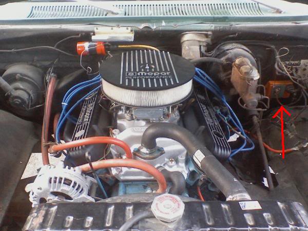

You must be talking about one of these....
Attachment 17396
This is on a 1978 D200 pick-up that I had with a 318. I had the supplied ballast resister installed per instructions. This coil was designed just for Mopar as it came with the proper ballast resister. I believe I got it through Summit Racing.

Yup, except my ignition control module is stock, not aftermarket performance. I have two questions for you:
1. Do you have an epoxy filled coil? I see you mounted it horizontally. Most of what I am finding are oiled...
2. My stock ignition control module already has a factory ballast resistor setup with it and the coil. Will that ballast resistor work if I replace my factory coil with an MSD Blaster 2, or do I have to install a second ballast resistor per MSD instructions?
