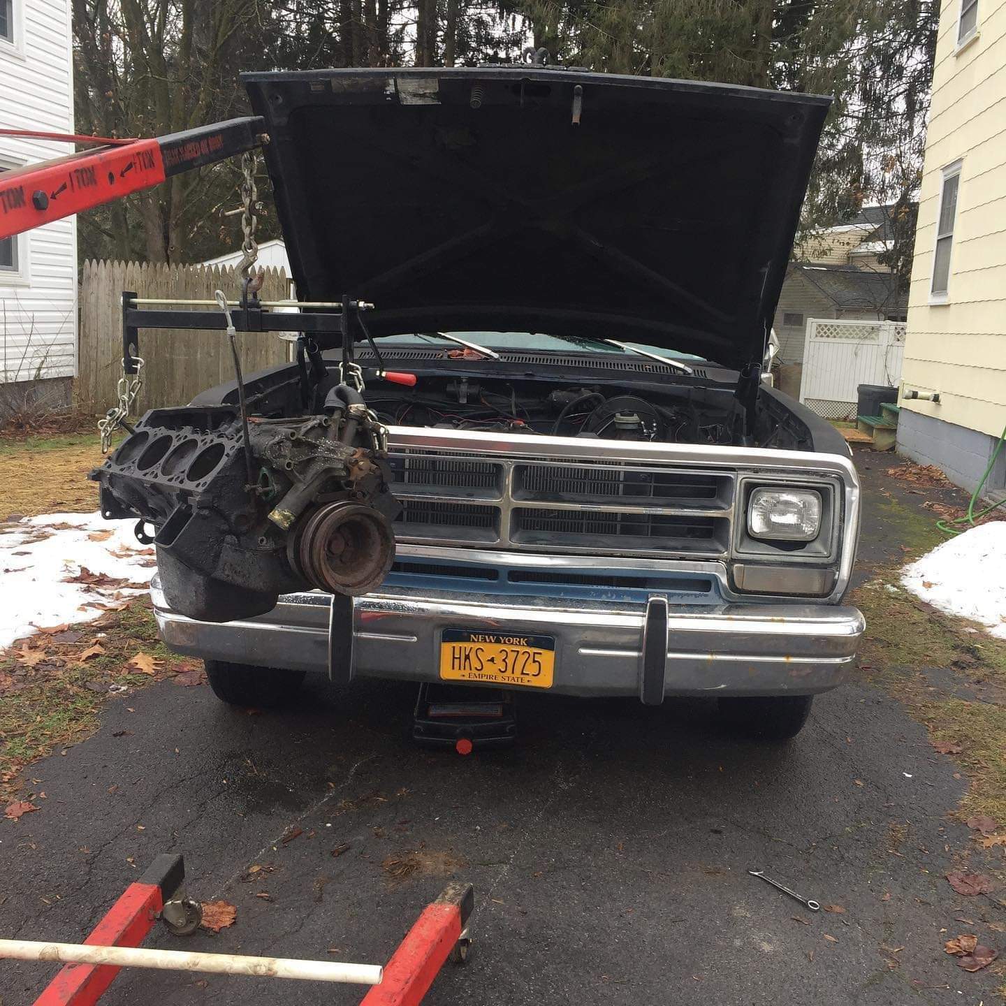

I'm starting a engine rebuild for my 88 D150, figured I would sign up to pick some of your brains!

Welcome. Looks nice. What's your plans?
