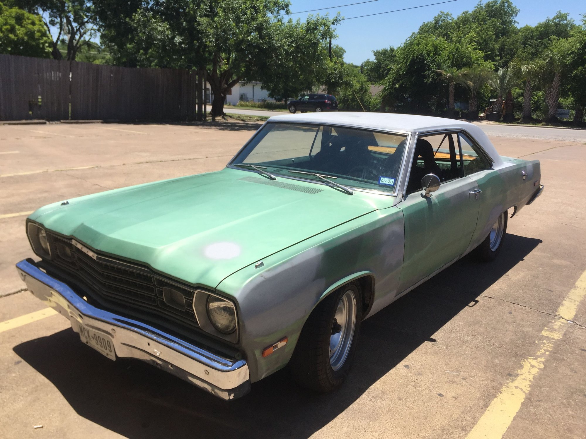

Here it is. Needs everything. The guy before was going to create a drag car...with a 318? Really? Guess he was not planning on going that fast. Just go to the track and hang out I suppose.
