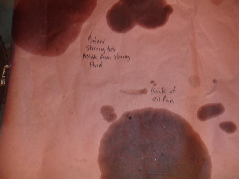

Trying to figure out where this leak is coming from. Cleaned bottom of trans and oil pan and layed down paper. Seems to be leaking from where the small rubber nipples are at the back of the oil pan where the pan meets the trans. I think I found the power steering leak.. I tookthe plate off the trans and checked for oil. Nothing in the trans..Any help is appreciated..

could the oil leak be coming from the engine?
Old Jan 30, 2010 | 04:00 PM
Rear Main seal????

oil sending unit or back of intake seal.

Possibly bad oil pan gasket cracked maybe?

tightened all oil pan bolts and valve cover bolts. No such luck. Appears to be rear main seal. Not sure if I can tackle this myself, and don't really have the funds to have it done. I'm going to try Barrs rear main seal leak repair and see where it goes...
Old Feb 8, 2010 | 03:48 PM
sounds like a similar problem that most mopars have
how much oil does it lose?
