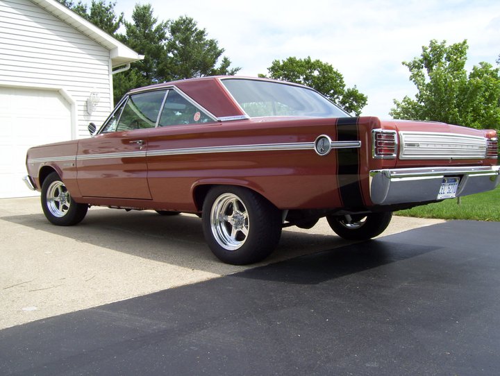

I have a '66 beldvedere which is the exact same vehicle, different trim level and I have the *** end raised a bit with leaf spring extension brackets on the rear. Does the job without strain on anything that shouldn't be strained. They were on the car when I bought it so I can't direct you where to get them, but I think they're fairly common.

I've had air shocks on both my Road Runners since buying them in 1976 and 1983 without any problems. Maybe if you have a rust bucket you might wish to stay away from them. I have also used coilover shocks in the past without problems. The last thing I would use is shakles as they look hidious and end up collasping your leaf springs.

I'm not talking (and I don't think he is either) about putting rediculously long, ugly shackles on that will jack the car up 8 inches, I'm suggesting a suttle, small shackle like I have (see pic) that gives the *** end a bit of a boost. I don't remember 1966 Belvederes being high speed cornering machines no matter how low you have the rear end. And as far as air shocks being the solution, I've seen too many horror stories posted about shock towers cracking under the continuos load of the vehicle.....and they aren't all "rust buckets".
