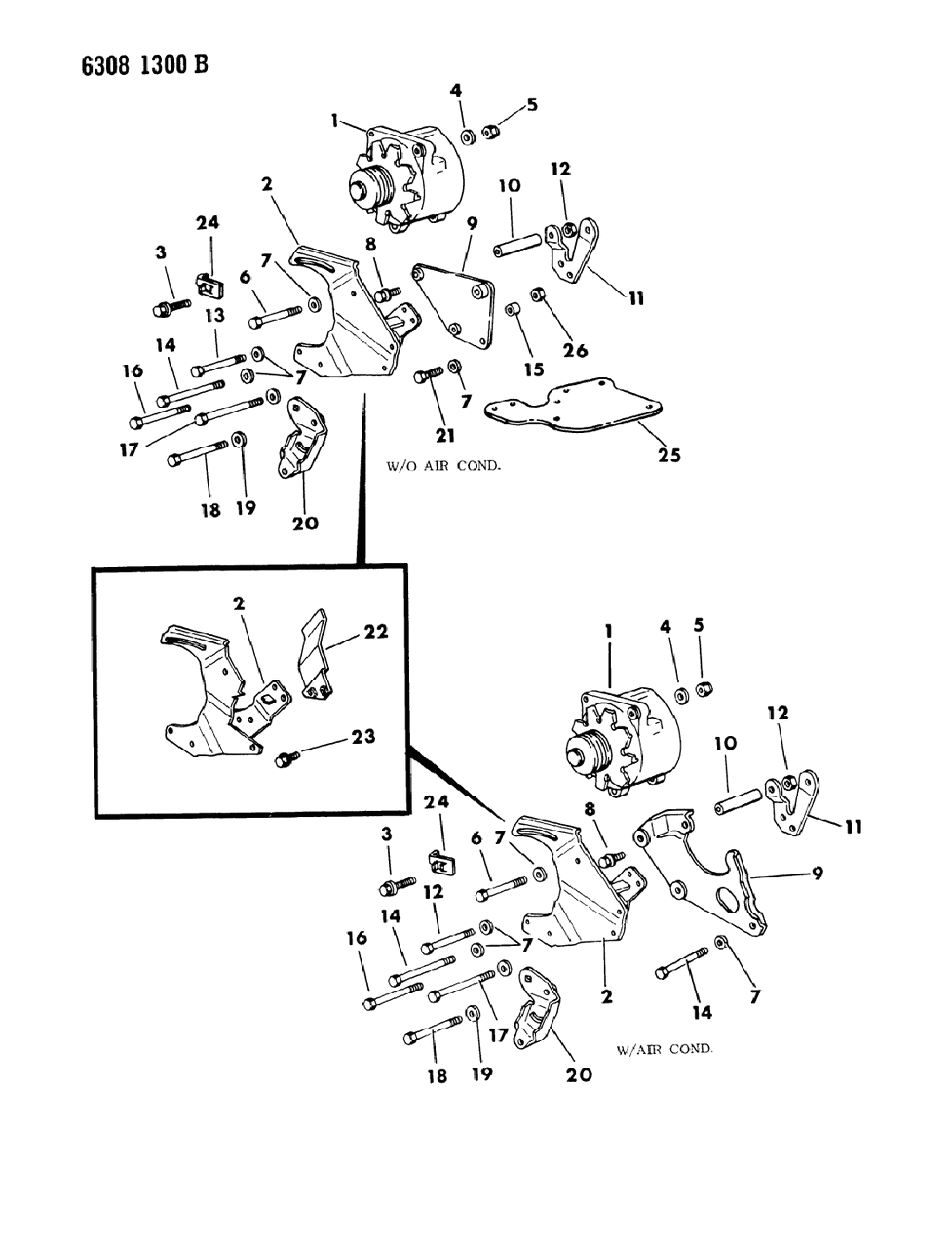

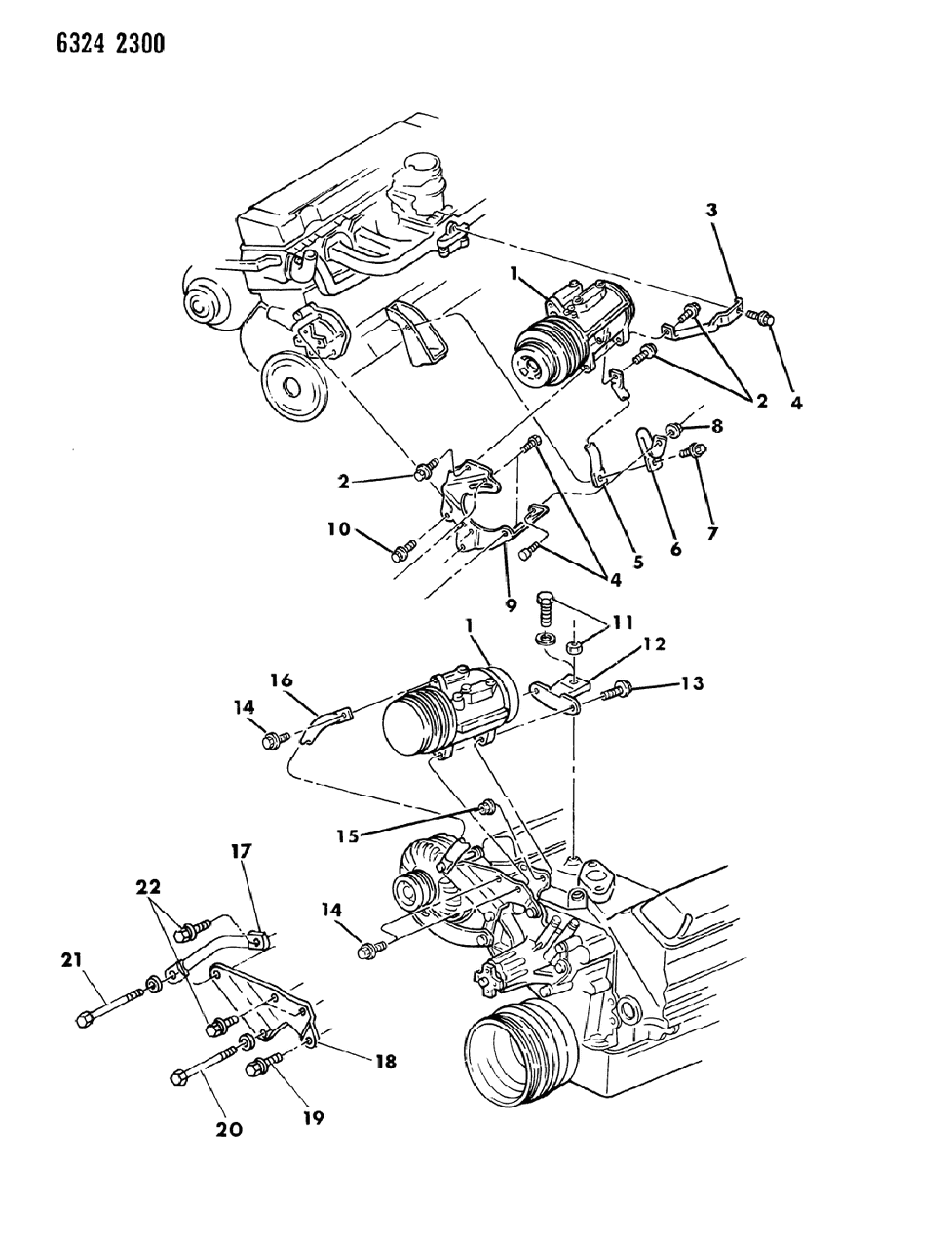

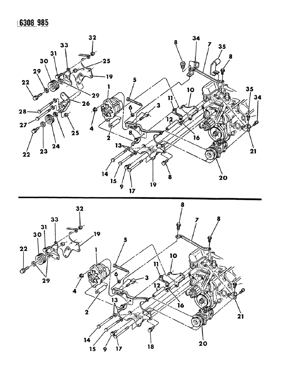

I'll give it one more try. I found these on www.moparpartsgiant.com
If nothing looks familiar I wonder if your dealing with an engine that is using a different bracket/pulley set. Pictures of what you have may be helpful.

I believe these contain what I may need. I really appreciate your time and help. I will let you know after this weekend if it is. Thanks again.
