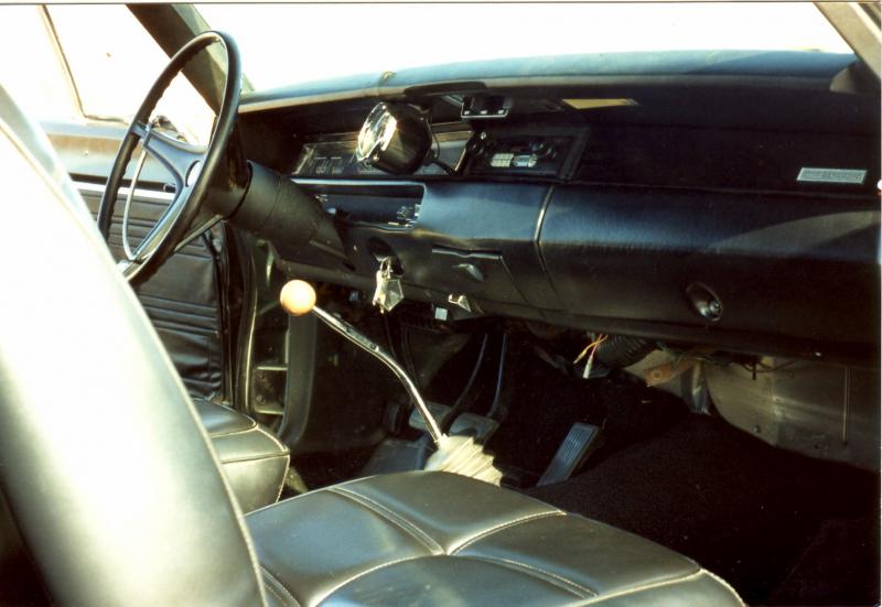

Hey guys my 68 coronet r/t currently has a pistol grip set up. I'm thinking I want to put the original 68 correct shifter back in it. But I'm not sure which one it is. It was originally a 4 speed console car and I plan to put a console back in it.
Now I don't think that the pistol grip was available until 69 or 70. Correct me if i'm wrong there. Here is a link to yearone. I'm not sure which one of those are correct. I know it says the px101 is for 68 and 69 but If I remember right most of them that I've seen with a 4 speed either have a white or black ball, not wood. I will also need the chrome rod for a console so if you guys could point me towards the correct one of those as well.
The pistol grip is really cool but it seems way too long to me. It feels like you have to move the shifter a foot to a foot and a half before you hit a gear. Almost what I would imagine driving a big semi would be like lol. Also when its in first and reverse it will hit the dash if you push on it just a little. I'm not sure if they all feel like it take this much of a stroke to shift them but the original shifter looks like it would be a little shorter and a bit more sporty feeling. Any advice here would be great. Thanks guys
https://www.yearone.com/Catalog/1966...ion/?year=1968
Here is a picture of the interior. Sorry don't have any better pictures at the moment. And the shifter was in neutral here. It would almost against the dash if it were in reverse or first gear.

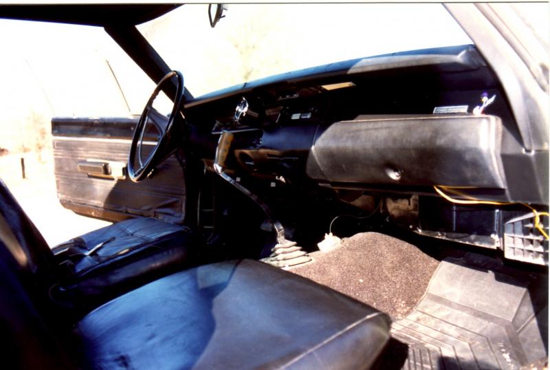

Yep, B's & E's starting in '70. The '68's had two available shifters, the Inland type which was replaced during the model year with the Hurst. I had a '69 Road Runner non-console 4 speed that someone put a pistol grip in and your right, it was like a truck shifter, I hated it. I lucked out and made a swap with a friend of mine for a stock '69 Hurst, much better!

A console Hurst for '68, in a friends unmolested '68 Hemi Charger R/T, you can see it does have the woodgrain ball...

On the Road Runner it made a massive difference, so much better with the correct shifter. I swapped the entire shifter, mechanism and all. My pistol grip had a ton of slop too, must be something about them. It looks like the pistol grip was in reverse, I always put it into reverse when I parked. The other pic the shifter is in neutral, I remember the day I took the pics I was also shooting video and the engine was running. Funny, I can't remember what I had for supper last night but I can remember pictures I took of a car over 20 years ago
