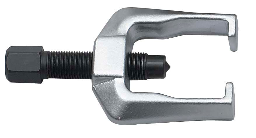

You need a puller like this:
I don't know for certain that particular one works in this instance, you'll have to measure and see. You tighten it up, and give a good smack with a hammer either on the side of the center link on the "hole" bulge, or smack the end of the puller screw
http://www.sears.com/shc/s/p_10153_1...e=35-7359977-2
http://s.shld.net/is/image/Sears/009...sm=0.9,0.5,0,0

got it guys. thanks for the advice. broke the nut, hit it with the air hammer on side a couple of times and then on the stud ,came off nicely and didnt even damage the threads.
