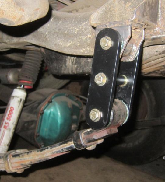

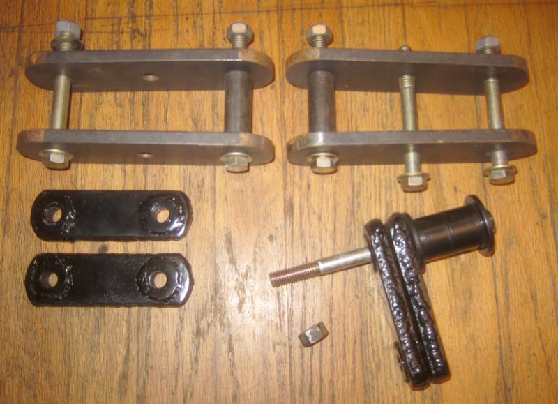

This is what I run... the rear are the noted D&C ones... the front are my own "Got Scout Monster Shackles"... which remain stock height... but are double thick and sleeved with welded grade 8 washers... and then I use the stock cross brace.

Get RID of those hokey extended shackles. Replace all rubber with Poly (if not already done so)... and put in a 1.75 - 2.25" bodylift.
For the front shackles... go back to the original ones, and use the center brace plate. It kills the road wander, and your current caster nightmare. Also put a 3°-6° steel wedge in the front spring pack to make driving polite.
Rear can have extended shackles... but use (make) better ones! 6" bolt to bolt is max, with a center bolt as well. Make from 3/8" plate. D&C Extreme used to make the best ones... google those and copy.
