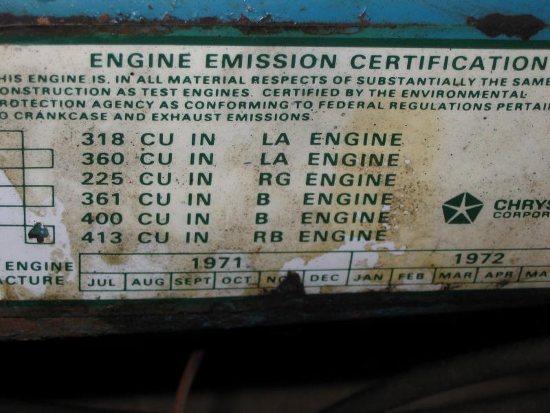

I purchased an RV and from the little information that I've gathered I think I have an early 70's 413rb engine. It isn't easy to get to the engine stamp on the front of the engine due to a humongous water pump and limited access to squeeze my head in there.
Only markings that I can visibly see are;
On the intake manifold has a raised stamp 3 712 6 and a triangle just below the 3.
There is a stamp on the left underside of the engine but I didn't document it, hopefully in a few weeks when I visit the RV again.
Any help would be appreciated.
[quote=413RB;15478]I purchased an RV and from the little information that I've gathered I think I have an early 70's 413rb engine. It isn't easy to get to the engine stamp on the front of the.....
Yeah, it's a 413 truck motor, {some call 'em industrial} Its got extra cooling capacity because of the special water pump and the heads are different too. Bottom end should be the same as the old 413 of the sixties. Its got alot of parts specific to the truck motor so some of them may be a little tough to find. Really tough powerplant though and the transmission is tough also {I assume its got an automatic}.
