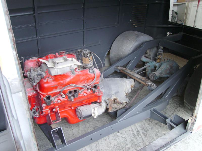

welcome and the 904 trans has more of a square pan on the trannie and the 727 has a L look to it

Also the 727 pan has a sort of bump to it toward the pass. side. It will also measure 35" from the front to the rear.
