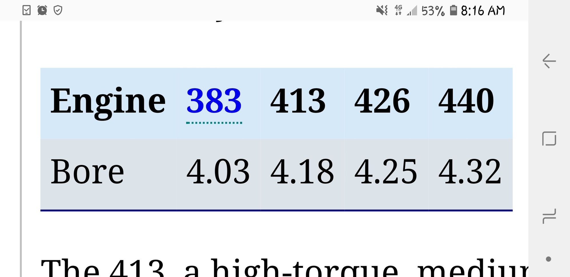

Can anyone tell me what you can bore a 1959 383rb out to. Can you use 400 pistons?
Old Apr 30, 2019 | 06:07 AM
No a 400 piston would be a 440 piston. I'm not sure but maybe a 413 piston. 383 rb only has a 4.03 bore. The 383 rb was a stop gap motor, mopar could not provide enough 383 b engine's so the quick fix was the rb.I dought there was a different block than a 413 but you never know. 4.21 is the bore size of the 383 b motor so dont confuse the two yours has a small bore long stroke.
