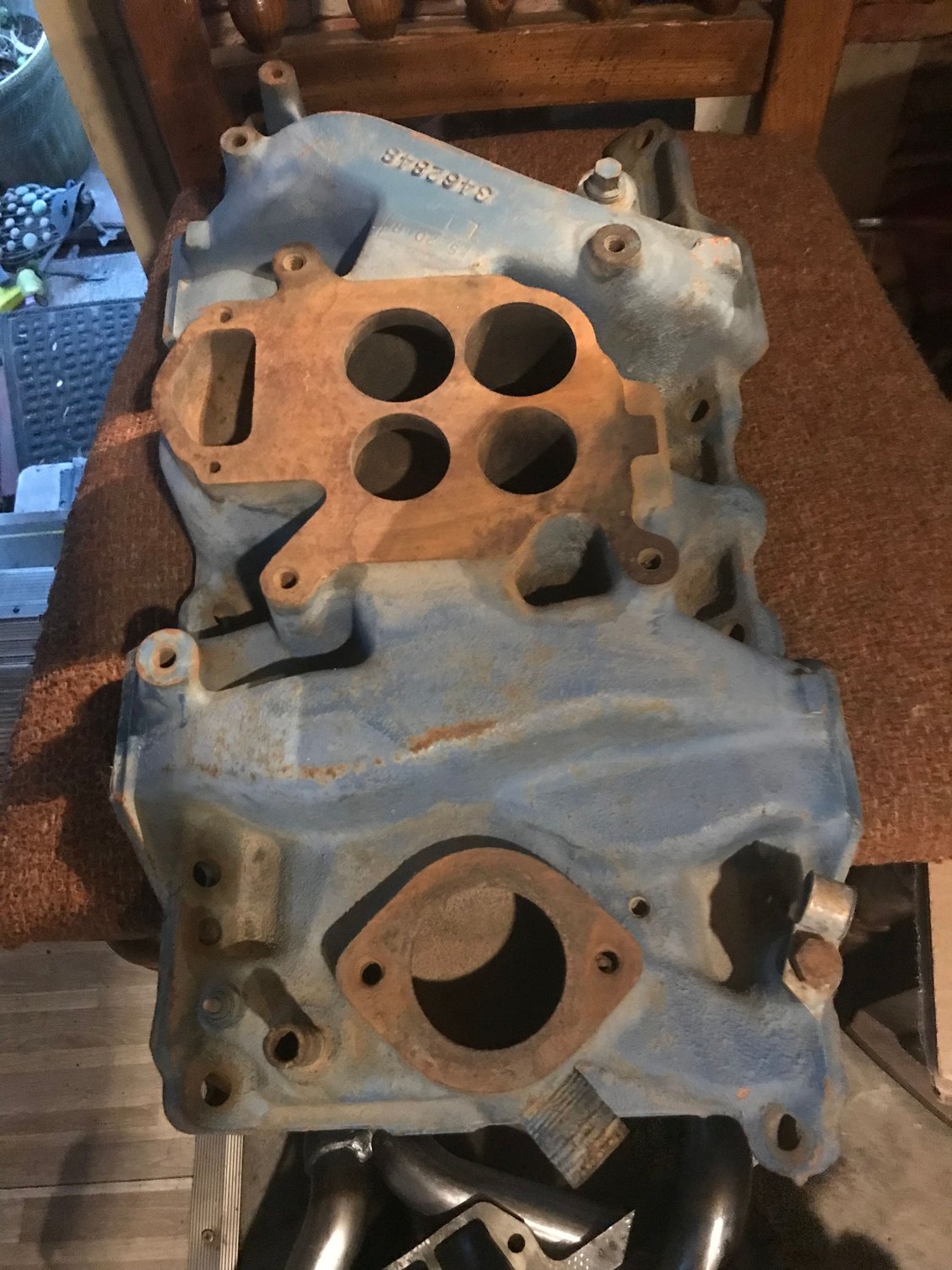

Good morning Mopar brothers. I bought this intake off an early 70s 340 and am hoping to put it on my 72 318. I came here for suggestions. I have a 1405 eldbrock and can buy the adapter plate or would you guys who know better suggest a carb? Stock cam 318 with headers. Thanks for the help as always. I know I ask more then answer.

Edelbrock spread bore 4 barrel or Holley + adapter, and as low a CFM as you can find.
While 600 is pretty std, lower might just work a little cleaner.
If you plan on a bigger cam, then start with the 600.
