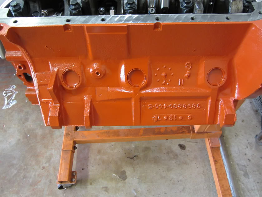

Look harder...on the side of the block you will find the date. Month, day, year format.
This is my 440 block see the 6-12-73 and the 440?

If i remember right, before 68 blocks didn't have the date on them. So it could be a pre 68 big block
