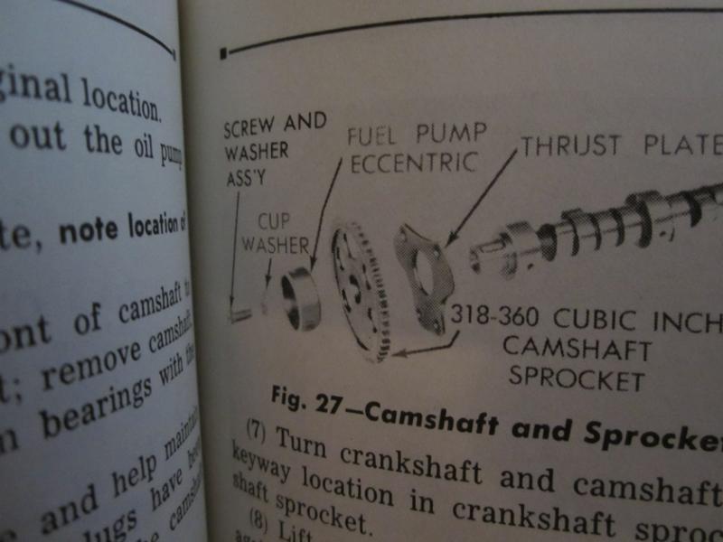

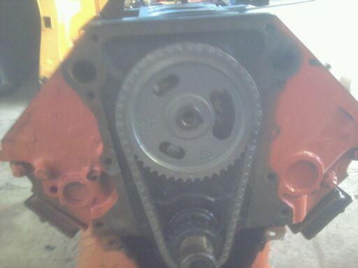

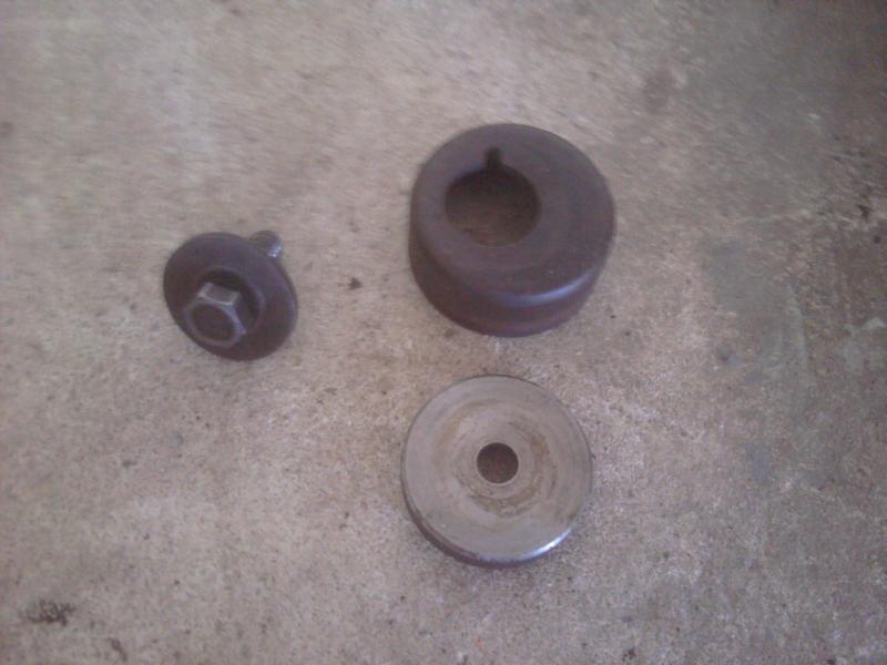

Does anyone have a diagram or can tell me what way this bolts on and if im missing anything..Thank you

That big washer is not used. That is your fuel pump eccentric that bolts to the front of the cam shaft.

Whats the cup washer it shows in the book and does the eccentric go in the cams keyway or bolt flush to the cam

I see how it goes now..do you have any idea where the big washer goes?

Does it fit inside the fuel pump cam ?? Something to re enforce the cam other wise I have no idea, never seen one used..
Put a dab of lock tite on the bolt !!!!

Yeah it fits perfect i think that's the "cup washer"..Whats the best repair manual for just a 318 LA>
