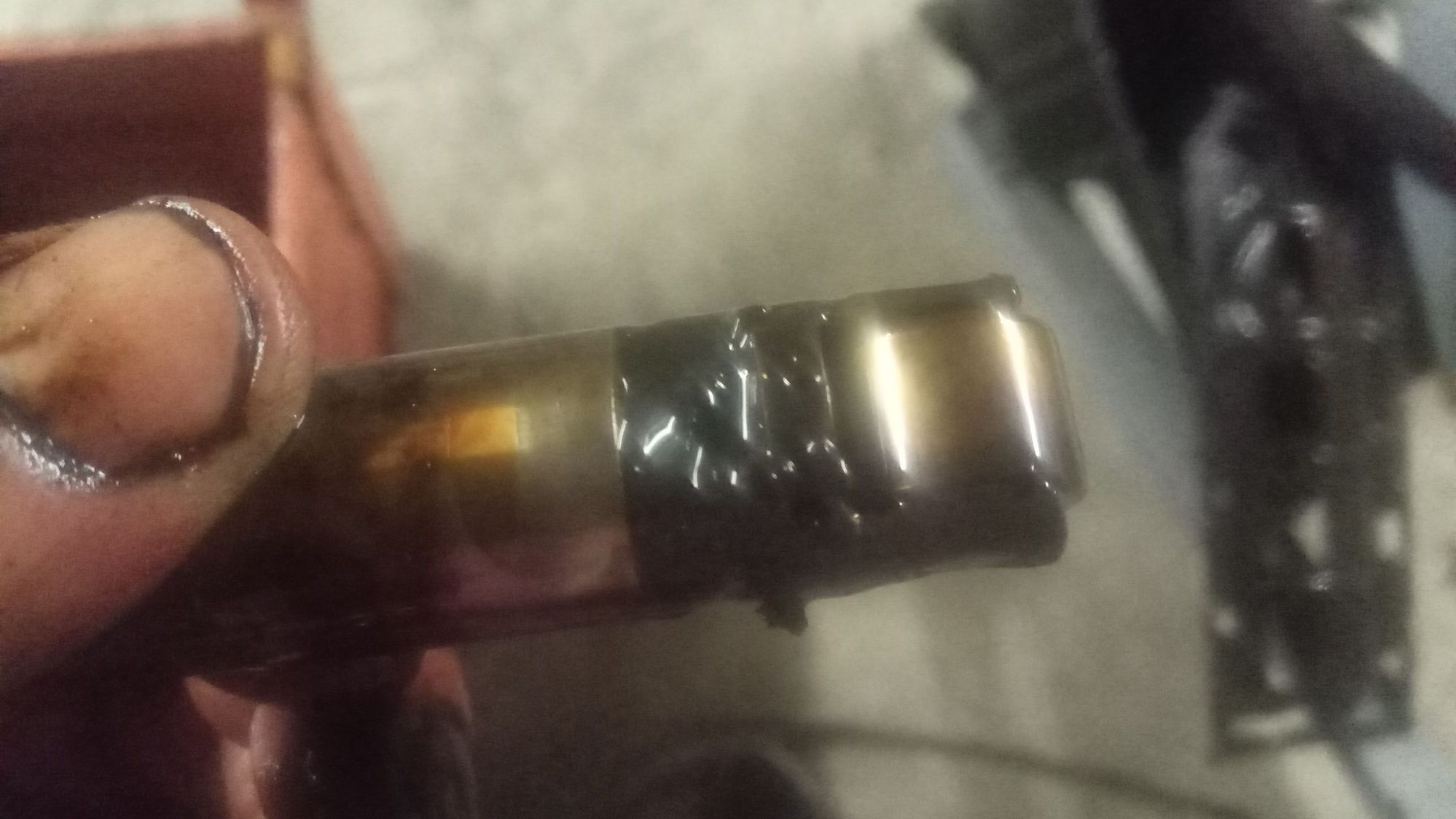

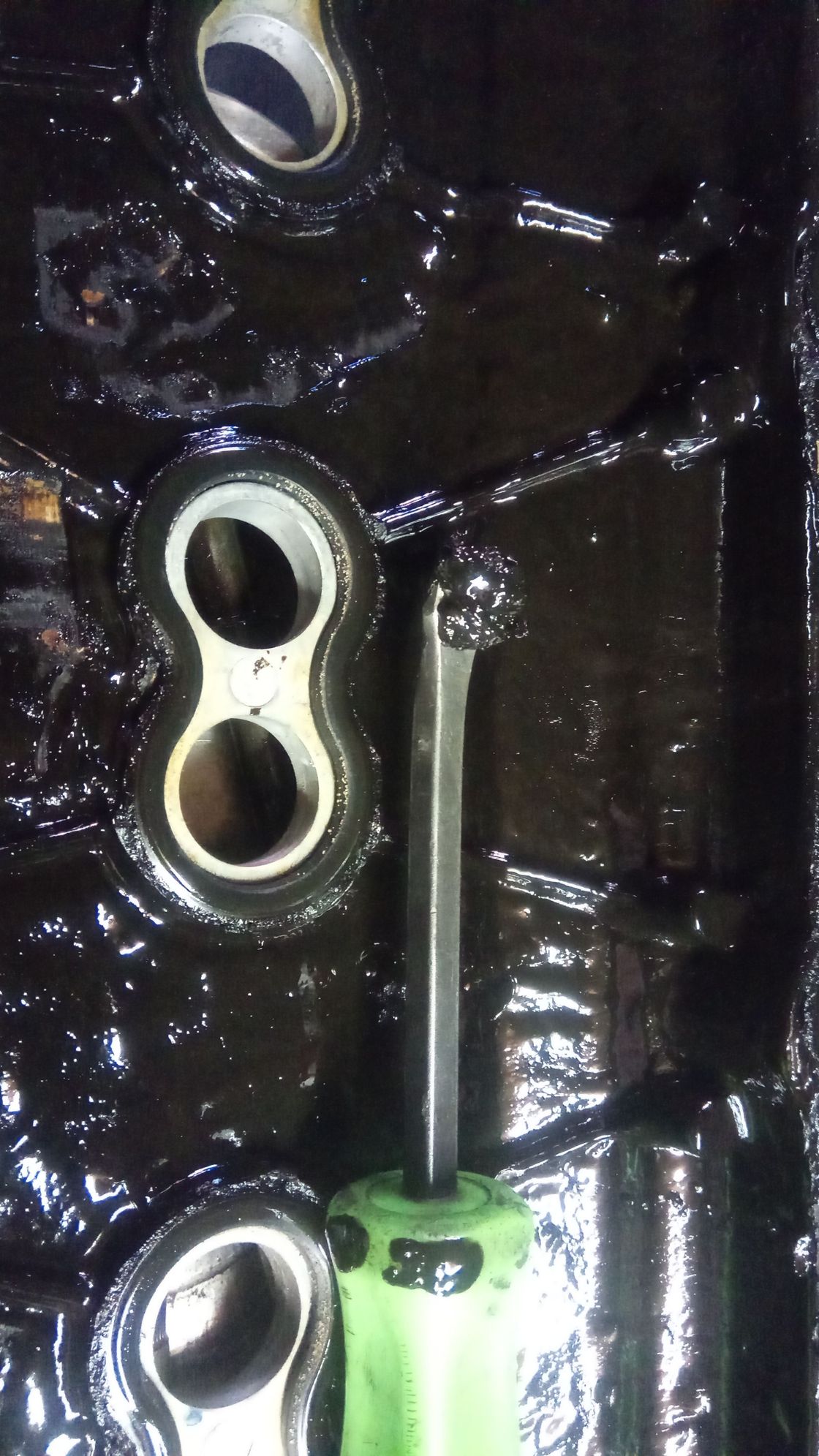

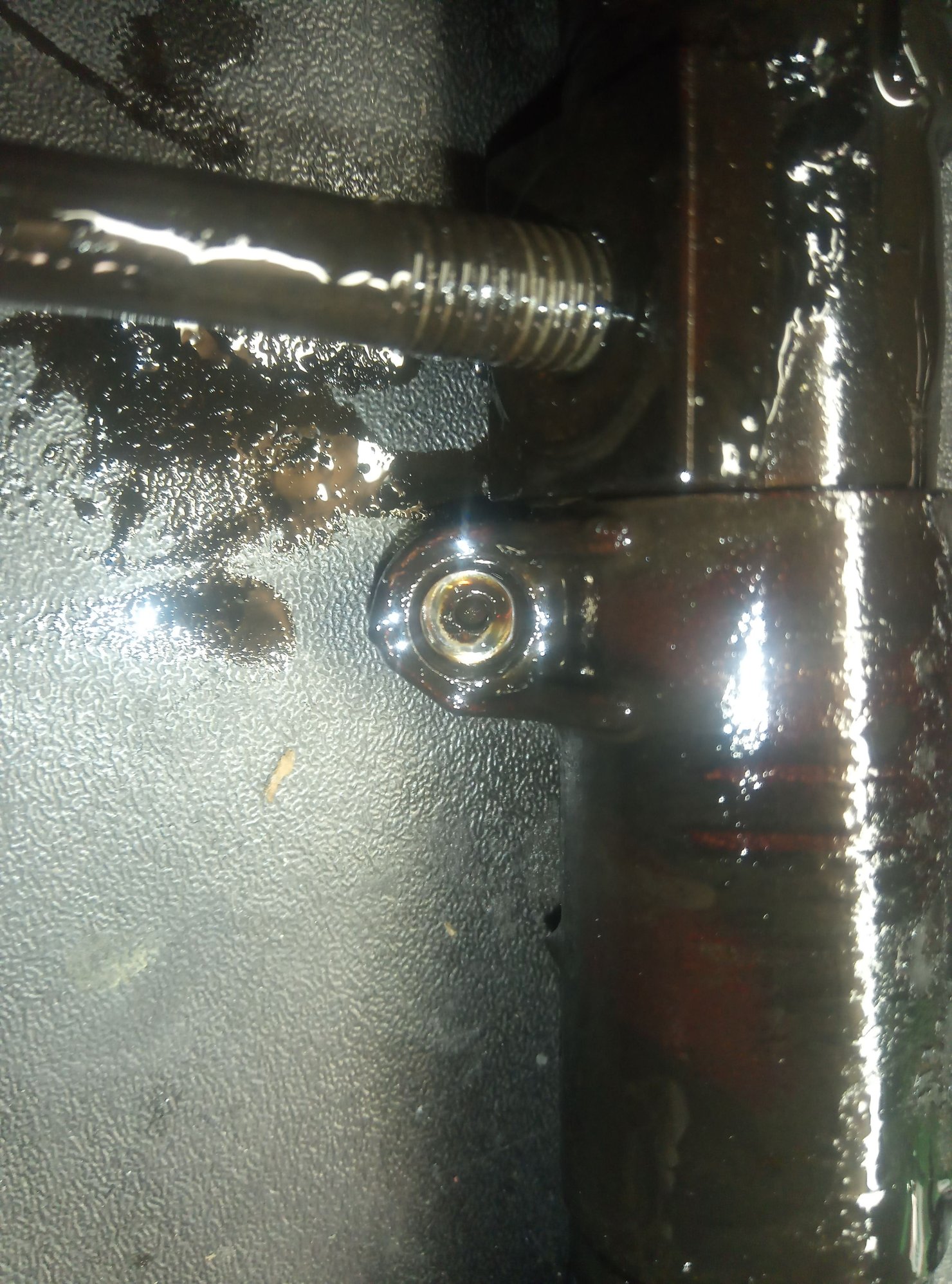

Hi guys, i'm on the process of rebuilding a 2003 5.7 L., that came out from a 1500 Ram, got it for a decent price but it's got seized bearings, so i took it apart and found 2 quite bad connecting rod bearing, 1of them spun into the rod bore so i have to replace it with a new one, what i found really amazing is the amount of sludge and nasty gunk into the engine, looks like the owner skipped a few oil changes! i've never seen anything like that, have you seen the pictures?
That said, main bearing, pistons, lifters and cam are surprisingly ok, however , i found that some of the pushrod ball tips show some wear , more likely due to the lack of oil just before the engine failure, even some of the rocker arm cups have some wear, they're not to bad really, what i see is that some of them have the shiny round area larger than others, like if the rocker cup is slightly deeper due to the wear itself, my idea was to buy new pushrod and try to re-use the old rockers, is that totally wrong? I'll post picture of the rockers and pushrod ASAP.
The hard part now is to clean the gunk from it, i'm thinking to make a sort of home made hot tank but i'd powerwash it first , took of all plugs in order to clean all the oil galleys and passages.

I power washed the block today, took lot of time to clean oil galleys and passages but I'm happy about the result, then blown with shop air through any single hole and galley, I'm sure an hot tank wash would be great but I don't have it and I want to be 100% positive oil passages are clean so I did it myself. I previously honed the cylinder walls with a hone Stone and it worked just great, since I'm not going to bore the cylinder because pistons and cylinder were in very good conditions, next step will be to machine 0.25 mm the crack, I'll keep you tuned

Hi guys, here a couple of pictures of the rocker arms wear , you can see the shiny larger rocker housing VS the smaller and darker one , I'm wondering if with new pushrods I'll be fine, my concern is about the oil flowing through the rockers rail then pushrods, what do you think?
Old Aug 20, 2019 | 01:04 PM
Posts: 5,486
The parts are not big money just replace them its cheaper than having a failure plus they are known problems.
