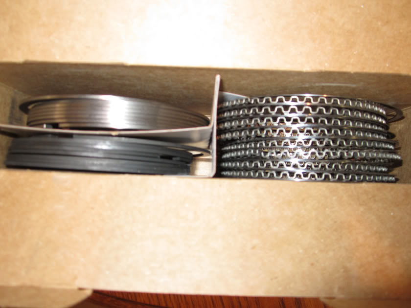

Shiny ones are moly rings and they are the top rings and the dot faces up.
The totally black ones are steel rings and they are the second ones with the dot facing up.
Duh the third wiggly ones are the third ring and there is a thin steel ring on the the bottom and top of it.

You need to pay attention to the placement of the ring gaps on the piston in relationship to the cylinder too !!! I like to install them with just a spray of WD40. Make sure the motor is ready to fire right away and run it 2500-3K rpm for 15-20 minutes
