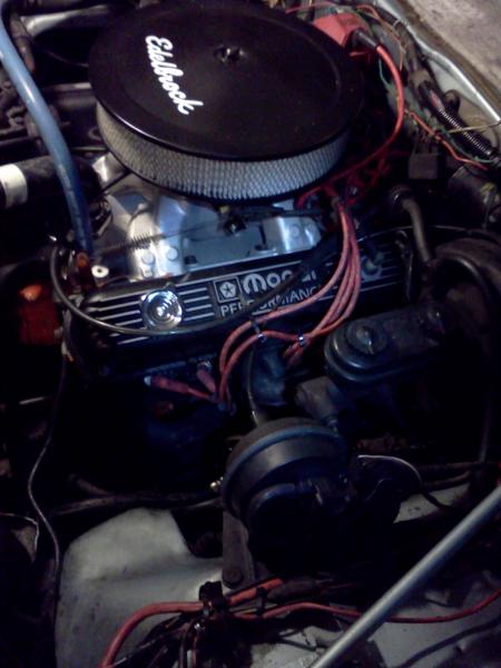

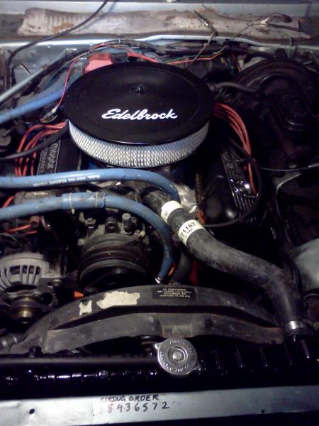

you cant easily accsess it on my 5th a stud-bolt for my set up is easier but still a tough thread to start.
as far as a set of valve covers in a 5th ave well... they are more for the motor and the motor... well you may laugh at the old mans car at the light but not at the next one, you may be looking down adjusting your radio.
