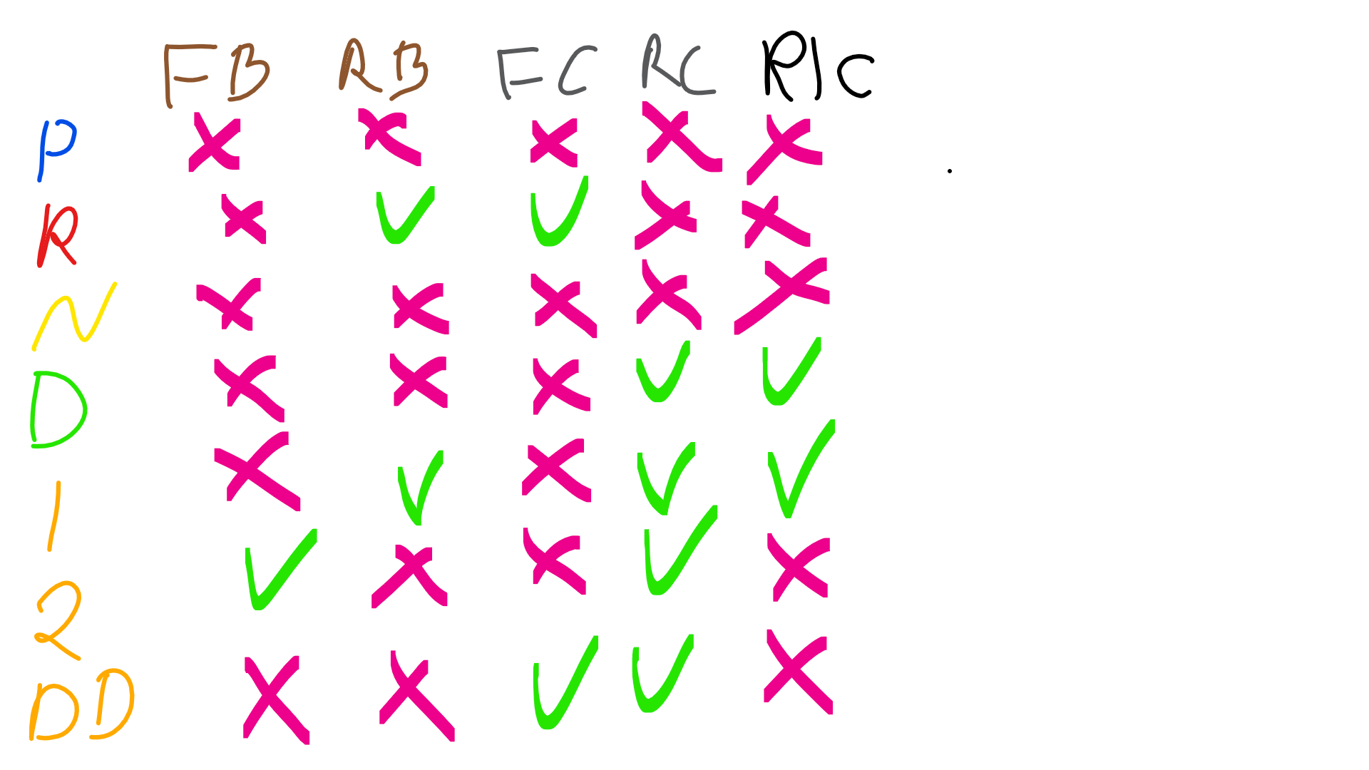

I've got a 727 Automatic transmission for my 77' Dodge B200 Tradesman Van. Bought the thing (not running) off craigslist for $200. Fixed the electrical and rebuilt the valve body. Everything works now except it can't Reverse and it drives in Neutral. I've tracked the problem down to stuck rear clutch plates (see my child-like diagram below). My conclusion is reinforced by the fact the car will lurch a bit if I press the gas in PARK, drives in NEUTRAL but only in first gear, and is completely stuck in REVERSE.
The question is, do I drop the transmission and replace the clutch plates (Rock Auto rebuild kit: ~$100) or just buy an used one for ~$450? The main issue is that I'm fairly busy and we're trying to get it ready for a road trip to Las Vegas in mid-October.
Thanks for any insight/recommendations!!
(NOTE: the green check marks indicate that the component should be engaged in that particular gear.)
