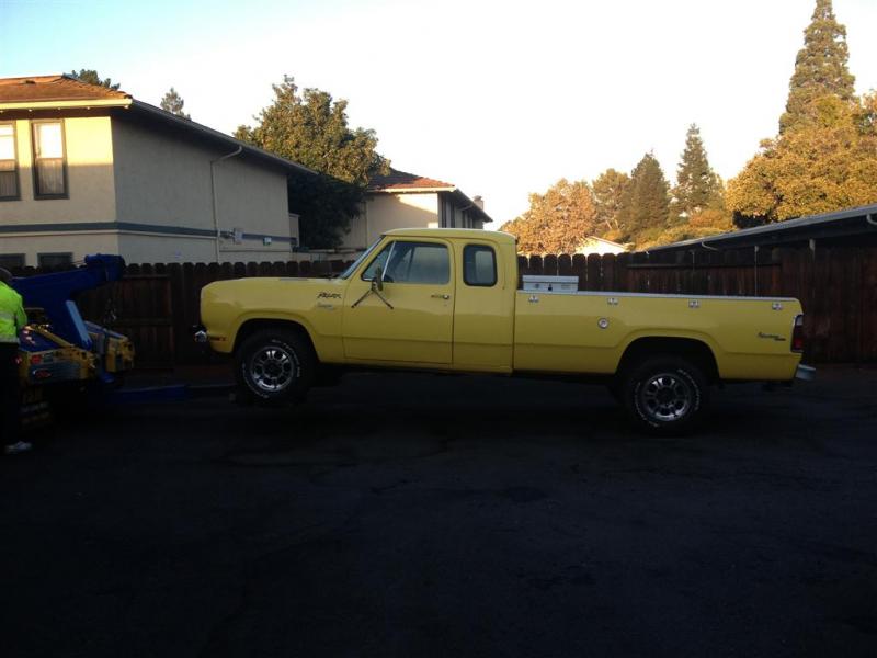

After spending most of the year dealing with problem after problem on a mid size truck.. I ended up trying to stick it to the man and purchased the truck I wanted. Full size extended cab 4x4, smog exempt long bed. I bought it Eight weeks ago and have driven it a total of about Two days. The truck is as follows: 1975 Dodge W200 Ext. Cab Long bed. 31" Tires, Dana 60 rear, Dana 44 front and both have 4.10 Gears. 360 four barrel and 727 transmission with a divorced 205 transfer case.
I am working on getting the oil pan gasket to seal correctly so that I can begin driving it on a daily basis. That way it can be a Working progress and not just a Project I am working on.
I live in Concord, Ca and I would like to find some quality mopar fans/mechanics, that may be able to help me with my project. I need this truck to be a daily driver for my business and I have a lot of plans to improve the truck over the next year.
Any help or directions on where to look for help would be greatly appreciated.

I have removed the oil pan, and ground down the brake line bracket that is attached to the cross member. I did not grind too much to alter the strength of it, just enough to make more clearance for the oil pan to go back on. I am planning to replace the gasket add Slick 50 and quality oil and get the truck back on the road by the end of this weekend.
