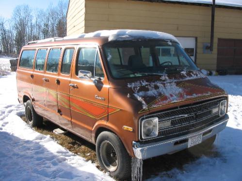

Not really ready to do this yet but the gas price situation isn't going to get better. The van is a b-200 3/4 ton with a 318 727. What would be the best way to go. If looking for a doner in the scrap yards what should I be looking at. Probably looking at starting to gather parts and maybe this summer yet to get it done. Getting about 8 mpg now so no road trips unless some one is buying the gas. What kind of improvement would I be looking at? Taller tires will be in the mix. How do I correct the speedo for this?

This is what I am looking to learn. Looking for the 727 varients. a500 or a 518 I think they are. The motor runs great and I would like to keep it. Can the motor be tuned ( cam, gears, tires?) to dial in to the power band at cruize or should I just get a complete set-up from an overdrive van? Not a service van but the one pictured. I know service vans were equipped with overdrive so not sure of the reference there. I will need to install a tach to see just where it is now but would guess at least 3200 rpm at 65mph. Weight is about 4000# empty. Tire hight is 27"
