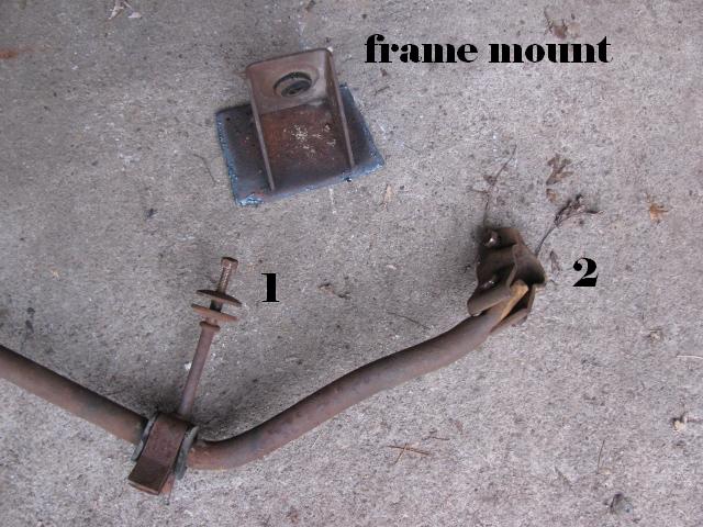

Number one in the picture. This set-up is out of a 68 Chrysler New Port.
My question is, how do I remove this link from the bar. I have an interested party, and don't want to damage anything. I just don't see a direct way without cutting out the rubber and then how would it be replaced.

If you mean how to remove #1 then most of them have a bolt but yours seems not too. The bottom pieces may be spot welded to gether. If you can locate the spot welds you can drill them out and or use an air chisel to break the two halves apart.

Yeah, there is no bolt. I will look for that spot weld. Drilling it out sounds simple enough. I just didn't want to ruin it for the guy.
Thank you very much.

removing number two and sliding off number one isn't an option? It's just a rubber bushing in there right? couldn't you get it to move with a hammer?

The buyer has a rebuld kit. So yep, new Poly bushings. The rubber has no give, maybe cause it is old. The bar end is a bit bigger than the outer diameter of the bar itself. I tried to slide it but no go, thought about burning it off but didn't realy want to stink up the place burning the rubber bushing. I would think a hammer would destroy the link.
The spot weld sounds easy enough though.

you may have to burn the old rubber out.

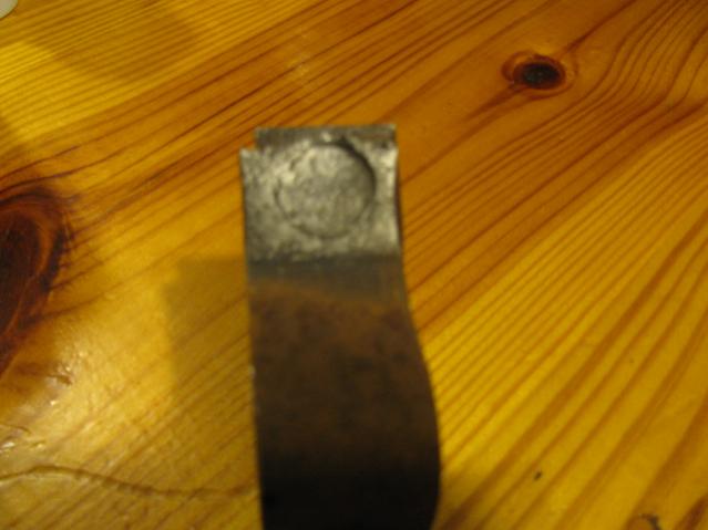

Any way it turns out the spot weld was way to big to drill out. It would not have enough metal left for a bolt to grab.
Notice the big spot weld on the link in the photo.
So what I did was drill out the hard rubber and cut the lip off with a hack saw. Viola came right off.
Hope this might help someone, some day.
