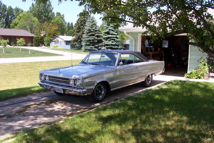

Just a photo to show why I'm so frustrated. I thought we did a pretty thorough job.
