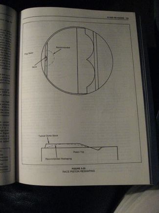

maybe these? https://www.summitracing.com/parts/jep-118758-1
forged 426 hemi flatop. Ross can custom make a set of 426 pistons, they will need to know the rod length you have. They are still available. Remember 426 Hemi rods are something like .100 longer center-center, than 440-6 or 426 MW rods.make sure everything matches so you do not extend outside the top of the block. REF: direct connection engine speed secrets. Hope this helps. let me know, maybe I'll do this to the 426W I have for sale. STD bore for a 426 is 4.25" the link has 4.28domed pistons. a
