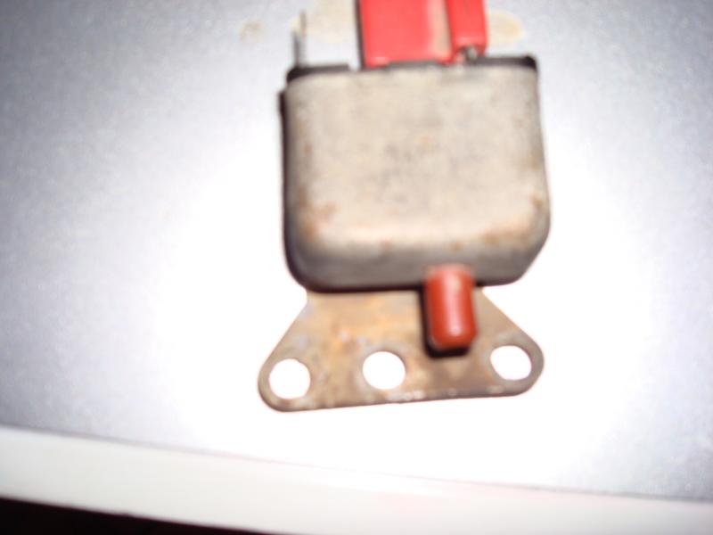

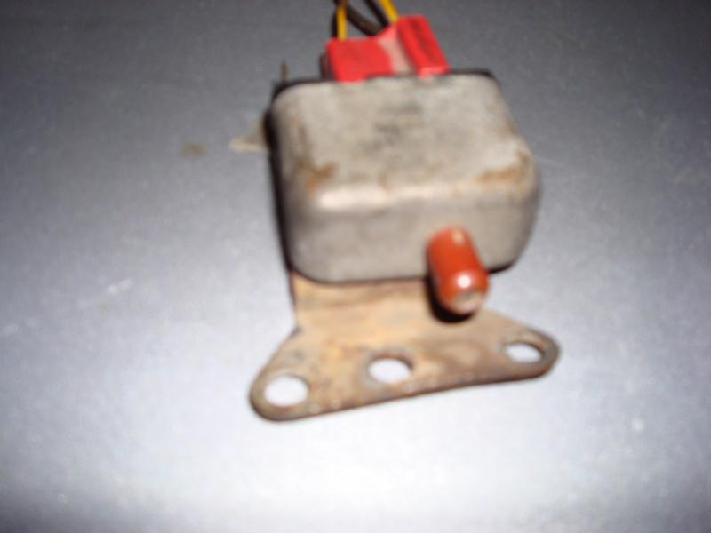

i found the problem... it looks like a relay but it has a button on the side works like a breaker i guess it located on the driverside next to the windshield washer bottle ...... i have to press and hold it and the key works fine .....try to get a new one from autozone... they dont know what it is and ideas

Sounds like an add on that an other owner did. i never heard of a breaker located in that area. the previous owner could have replaced the fusible link with a breaker? and yes it normal to put it in gear without pressing the brakes. thats the way older cars were.
duster74 Feb 8, 2009 09:12 PM
im pretty sure is not a add on i checked the haynes repair manual it doesn't say or talk about it but it comes out in illustrations
66sportfury Feb 8, 2009 09:32 PM
that could be true... but a relay usually dont have a button to reset, the common ones are spdt relays and they dont have a reset. well anyhow did you get it running right?
duster74 Feb 8, 2009 10:06 PM
it starts now i had to put a screw in the botton and hold it down with some tape....... i dont know if its a relay but im trying to fine out what it is so i could replace it..... i dont know if its going to cause damage down the line by not working properly ......it must be there for a reason
66sportfury Feb 8, 2009 10:46 PM
do you think you could post a pick? a fairly wide one with a arrow pointing out the relay... just cuz id like to see it thats all.

i tried with the seat belt still nothing.....yeah in a 74 plymouth duster.... i went to a dealer they dont know what it is.....they think it could be a alarm cut off switch they looked it up in a catalog and if it is that they dont make that part any more..... just thinking of just eliminating the switch.... ill post a pic of it tomorrow

duster74 Feb 10, 2009 08:54 PM
2 Attachment(s)
this is the part i been talking about Attachment 554
Attachment 555
66sportfury Feb 10, 2009 09:29 PM
i dont recall seeing on of those on a mopar but it looks to me like a simple breaker.

Commando Feb 11, 2009 05:41 AM
Are there any numbers on it? If you turn the button does it tighten or loosen, perhaps it is a kill switch that you turn to engage/ disengage.
