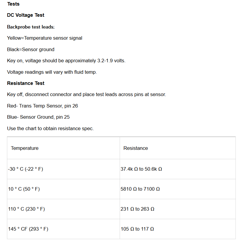

Does anyone know the resistance chart for 948te transmission temperature sensor or what type of thermistor it is.
2015Promaster city
Thanks

2015 RAM ProMaster City Base 2.4L Eng
