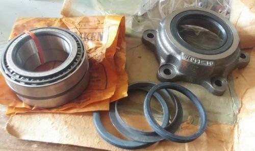

I was able to locate a NOS retainer on ebay which also comes with seals and set of Timken bearings. Hopefully this will fix my problem.

I been giving it some more thought and I think I'm going to wait on this repair. I don't really have the time and plus I really believe it's the knuckle thats worn so, I think I'm going to plan for this repair and source a replacement knuckle so I can fix it right if worse comes to worse when I tear into it.
[update] I got this fixed. I caused this issue by using an oring with too big a cross-section under the retainer cap. I removed the oring and use rtv instead and that removed the play in the bearing. [/update]
