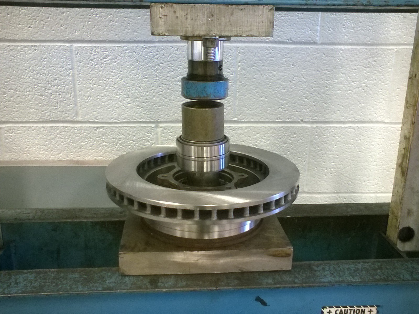

Attached Thumbnails 44-fbj minor wheel play-10923d1483166674-12-point-bolts-fulltime-dana-44-front-hub-assembly-pic15.jpg

I don't think it could be the hub, those bearings pressed on pretty tight.

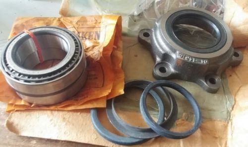

Attached Thumbnails 44-fbj minor wheel play-17862d1503427150-dana-44-front-hub-assembly-round-two-picture-3.jpg   44-fbj minor wheel play-10922d1483166674-12-point-bolts-fulltime-dana-44-front-hub-assembly-pic14.jpg

I was able to locate a NOS retainer on ebay which also comes with seals and set of Timken bearings. Hopefully this will fix my problem.
